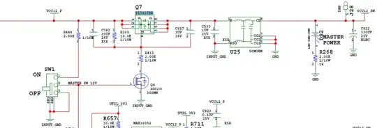

Attached is the snapshot of Xilinx evaluation board schematics. I referred most of their schematics and observed that p-channel mosfet are used in power circuits. Is there any special advantage of using p-channel mosfet over n-mosfets.

  • You can consider power circuit of Xilinx ZC102 evaluation kit. I have edited my question and attached the image there – Shifali Jan 06 '21 at 13:50
    They aren't always. N-Fets tend to be more efficient, but for high side switches, P-Fets are easier to drive. Your choice. –  Jan 06 '21 at 14:08

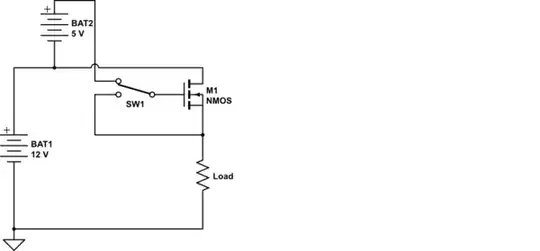

To switch a load where the ground is common using an NMOS, I would need:
schematic
Note how this circuit needs an extra battery to create a voltage that is higher than the voltage on the load. This is needed to apply a large \$V_{gs}\$ to the NMOS so that it will operate in linear mode and have a low on resistance (\$R_{DS,on}\$).
To implement that 5 V battery (5V is just an example), usually a voltage boost circuit is used like a bootstrap circuit or a chargepump. That's complicated! You'd need to have a good reason to insist on using an NMOS (there can be valid reasons but I will not go into that here).

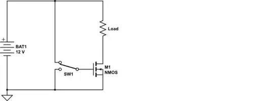

If the common ground for the load is not a requirement then you can use an NMOS like so:
schematic
simulate this circuit
and then an NMOS is preferred (as with a PMOS, you'd have to make an extra low, negative) voltage). This can be a good solution if your load is a (string of) LEDs, a lightbulb or a motor. It is often a bad idea if your load is a circuit as then that circuit can have an unconnected ground when it is not powered. That can result in very tricky behavior and you really want to avoid that (to learn why, watch this video by Dave from the EEVBlog about powering a circuit through its signal pins due to ESD diodes).
