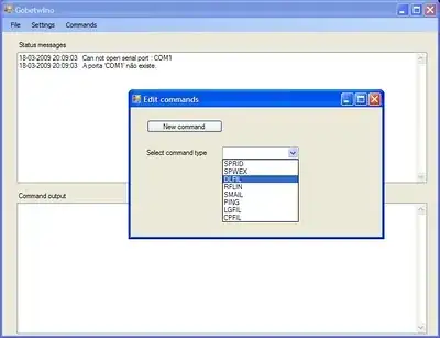

The program gobetwino will log sensor values from an Arduino to a text file or spreadsheet with minimal effort. It can also automate things on the computer, add timestamps (so you don't need to program them into the arduino), etc.
alt text
