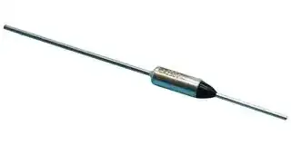

That puts a different light on things. This device is a 10 amp thermal fuse that operates at 73 °C. If it were thermally bonded to the triac/SCR it should offer some protection against sustained thermal damage on the triac/SCR. The two wires will be in series with the normal 10 amp fuse.
There are probably other variants that "operate" at higher than 73 °C and, maybe you might be able to replace the 10 amp fuse directly if you look into it more deeply.

    One more thought. Have you heard of thermal fuses? They should be able to handle the current you need but, will blow when they get too warm so, if you have one mounted on the triac it might work. Obviously, electrically its pins connect as per the normal fuse so it would be an extra fuse in series with the regular fuse. – Andy aka Dec 26 '20 at 12:33
  • Brilliant idea, please add it to the answer as well. thanks again buddy. – ElectronSurf Dec 26 '20 at 12:39
