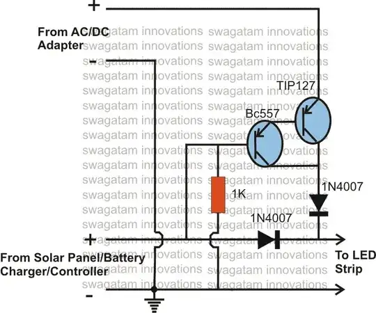

I am using this circuit as the automatic transfer switch where I am providing input from battery and solar panel and taking the output to run the motor.
Where AC/DC is written I am using the battery from this input where the motor is running slower and TIP127 is getting heated up and consuming extra energy.
As I have nearly no knowledge of electronics and took this circuit from a website.
It would be great if anybody could tell me why this is happening and how can I stop it?
As I want to make circuit very efficient and hence trying to reduce any kind of energy loss. Also when run via second input the motor is running extremely well.
Thank you.

  • What motor are You using? What current is it drawing? Why microcontroller tag? – fifi_22 Dec 26 '20 at 07:25
  • Using a bipolar transistor as a load management switch is a bad idea. a mosfet could do that more efficiently. look at this question : https://electronics.stackexchange.com/questions/283056/powering-circuit-directly-from-usb-while-charging-li-ion-battery-side-by-side – Tirdad Sadri Nejad Dec 26 '20 at 07:58
  • Tirdad Sadri Nejad What could be a better circuit capable of doing the things I want? – Tushar Dubey Dec 26 '20 at 09:56
    A lot of the weirdest and least efficient circuits posted here seem to come from that website... –  Dec 26 '20 at 13:36
  • Please [edit] your question and provide some data, like voltages, currents, power sources you use, where is the motor you mention, and so on. – the busybee Dec 26 '20 at 16:45
  • The diagram shown is taken from a website and power source used is a 3.7V li-ion cell of 2000 mAh and the motor used is 3-6V. I just want to know what could be a possible more efficient circuit if this is wrong which I want to use to drive a 12V motor powered by 4 li-ion cells in series. – Tushar Dubey Dec 27 '20 at 08:56
  • There's no base resistance. Perhaps there's excessive base-current? (depends on what is actually dtiving that base) – Unimportant Dec 27 '20 at 09:00
  • How to measure the base resistance using a multimeter? I can provide that also and anything that I am missing – Tushar Dubey Dec 27 '20 at 09:03
  • https://electronics.stackexchange.com/questions/74308/low-voltage-dc-automatic-transfer-switch I have come across another circuit diagram but I want to know how Schottky diodes will work in the given circuit and how can it work as an automatic transfer switch. – Tushar Dubey Dec 27 '20 at 09:10
    Scottky diodes from other answer will drop about 0.5V depending on current and diode rating. || In this cct - Take BC557 collector to ground via 1K. | Change existing 1K to 10K. | Place 1k between BC557 base and solar +. || Heating is probably due to slow change over between supplies with TIP127 dropping too much voltage. Hystsresis can be added but a better cct would be best. || The two x Schottky diodes will work OKish. – Russell McMahon Dec 27 '20 at 10:29
  • What is the point of the transistors? Could you not just use the diodes alone? – Bruce Abbott Dec 27 '20 at 13:02
  • I am from mechanical domain and I am using this circuit in my project so this is just a small part and also insignificant for me but it has to work in order for the model to work. Hence I do not have much knowledge if the two diodes will do fine. And my aim is to keep the power in the circuit even when main supply goes down. – Tushar Dubey Dec 27 '20 at 15:52
  • @RussellMcMahon can you explain to me how will the Schottky diode circuit work and which between 2 circuits i.e. Schottky diode or TIP127 circuit is better to used. – Tushar Dubey Dec 29 '20 at 04:49
    Your cct above is very badly designed by the "designer" and has little or no advantage over 2 diodes. The Shottky diode circuit here that you have mentioned powers the load from the highest voltage source. If the mains adaptor voltage is even slightly higher than the PV / battery voltage then the mains supply diode will conduct and the PV input diode will be reverse biased and will not conduct. You will lose ABOUT 0.5V voltage drop across a schottky diode - maybe slightly less. If you want almost zero drop a FET based circuit can be used. – Russell McMahon Dec 29 '20 at 07:37
