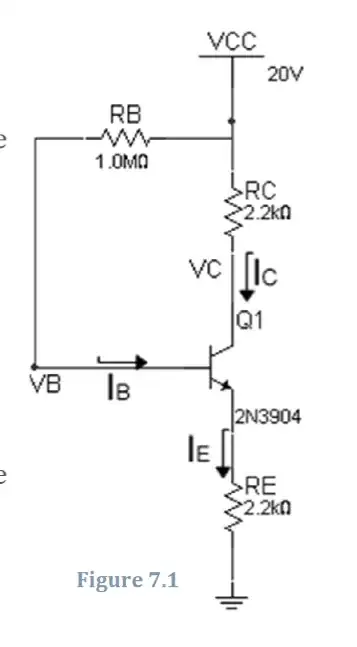

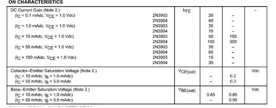

How can I read the Beta value of a BJT for a specific circuit from the datasheet? I tried to find currents first in order to find the Beta value but eventually I couldn't because I didn't had the Beta value. I couldn't make sense of the datasheet.
datasheet
Circuit

  • I didn't understand. I am provided with these two, data sheet and circuit. "Choose
    Beta from the given datasheet "
    – Csopso Dec 23 '20 at 23:41
  • the datasheet is reminding you, politely, that the specification for beta (also called h_fe) is a very inconsistently controlled value, just like the other commenters are saying. There are other parameters of transistors that are more reliable, but they are not quite as easy to compute. – Pete W Dec 24 '20 at 02:52

Let's examine your case on the left and, on the right, the usual one seen over and over again:
schematic
Note that I've drawn an equivalent schematic for CASE 2. The equivalent on the right side of CASE 2 looks a lot like CASE 1. But the key difference is that we can set two values, \$V_\text{TH}\$ and \$R_\text{TH}\$, for the CASE 2 where we can only set one, \$R_\text{B}\$, for CASE 1. So CASE 2 has two degrees of design freedom against only one degree for CASE 1. There are more differences as we will soon see.
I've also decided on a quiescent collector current of \$I_{\text{C}_\text{Q}}=3\:\text{mA}\$, as shown. Assuming \$I_{\text{E}_\text{Q}}\approx I_{\text{C}_\text{Q}}\$, the collector and emitter voltages can be worked out, also as shown. And assuming \$V_\text{BE}\approx 700\:\text{V}\$ then the base voltage also falls out, easily.
I didn't select the collector and resistor values. I just took the values you show in your question. They probably aren't very practical. But they are good enough to get a point across.
Case 1
Here, you need to find \$R_\text{B}=\beta\cdot \frac{20\:\text{V}-7.3\:\text{V}}{3\:\text{mA}}\$. But you don't know the value of \$\beta\$. And it varies a lot between BJTs; even ones from the same designation and manufacturer. It also varies over temperature and it varies when the collector current varies.
Let's just say a BJT is measured with the resulting value of \$\beta=150\$. We can now work out that \$R_\text{B}=150\cdot \frac{20\:\text{V}-7.3\:\text{V}}{3\:\text{mA}}=635\:\text{k}\Omega\$.
Using that exact resistor value we find that all the numbers work out. The base, collector, and emitter voltages are on the mark.

You don't. You get a vaguely representative value from the datasheet, and design the biasing circuit and overall performance to be relatively independent of the actual value.
Then, when Beta turns out to be 3x the datasheet value for the transistors you have in your hand, you are pleasantly surprised instead of disappointed.
And yes, 3:1 is a realistic spread of values.

Choose a beta somewhere in the middle -- say 50.
Solve the circuit for the collector current.
Now choose the beta that goes with that collector current. Go back to solving for the collector current, choose new beta, etc.. You should settle out to a value of collector current (and beta) pretty quickly.

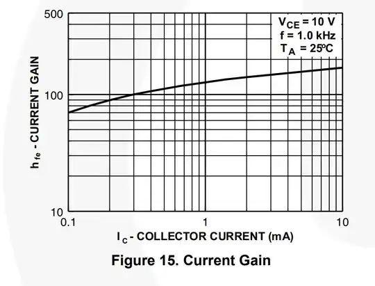

Image from datasheet of 2N3904 enter image description here
Your image of datasheet states minimum guaranteed value and typical.

  • I still didn't understand how can I use this information to use. Perhaps lets say I want to calculate the currents this circuit. For the Beta value do I use the minimum values? And which is 30? – Csopso Dec 23 '20 at 23:44
  • @CanberkÖzçelik Actually, you can't use the graph for your circuit. The graph shows typical values and is intended to show you how the current gain varies with collector current. The actual gain value for any given transistor may be much different from this typical value. – Elliot Alderson Dec 24 '20 at 00:02
