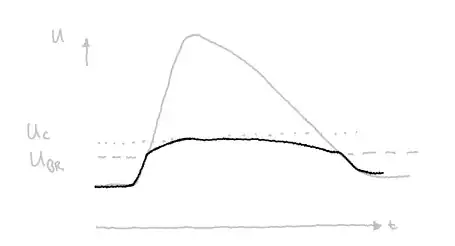

Additionally, VC is the Maximum Clamping Voltage which is the maximum voltage drop observed over the TVS diode, measured at its peak clamping current IPP. Voltage drop typically rises with higher temperature and higher voltage over the TVS.
For a transient voltage, the clamped voltage would e.g. look as the black line in the drawing. It is not flat as often drawn as simplified version.
TVS Clamping
because … the diode does not suddenly allow ∞ A after the voltage passes VBR.
