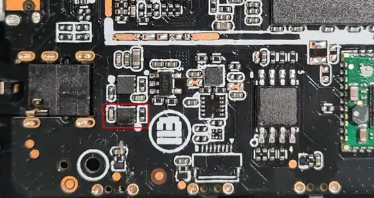

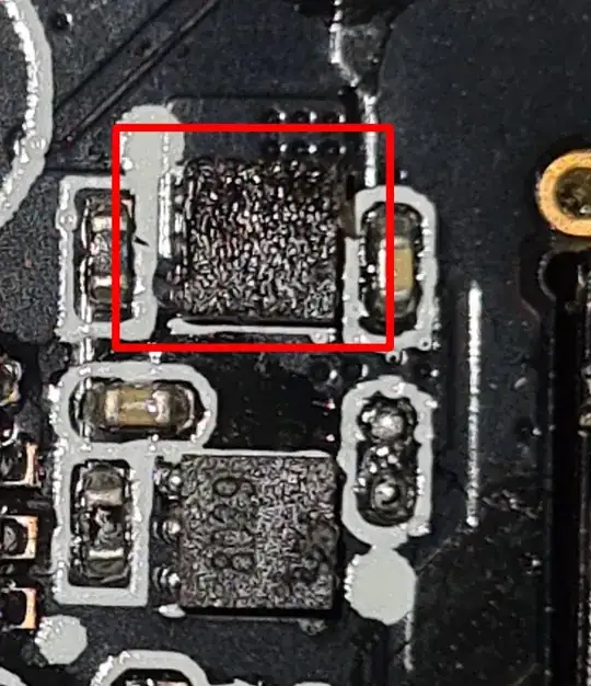

I have a Fusion5 tablet which is not working. There is a mosfet which gets very hot when I plug it in so 1st thing I want to replace. But I'm looked online and can not find where I can get a replacement. Is there places which sell there or can I get an alternative? Marking on one below which seems to be the same is 8029.
Thanks!
P.S to the left of the mofset is the DC jack. When I plugged in I used micro USB to charge as currently don't have the correct power adapter.

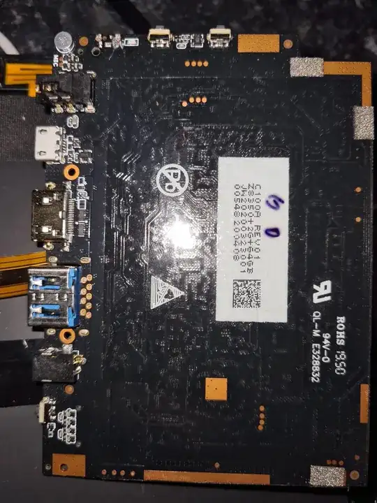

  • Part number of the motherboard? All I have is the tablet model is fwin232 and the systemboard QL-M E328832 rohs 19.50. I have put in pic of board in main post. – Peter Jackson Dec 22 '20 at 16:40

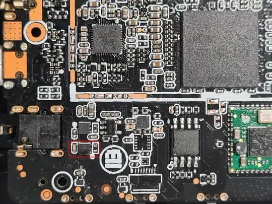

    Two similar MOSFETs pleaced adjacently, hmmmmm, smells like a battery management circuit or some synchronous DC-DC converter. OP, can you please take a picture of the 10-15 components in the neighborhood of this pair of MOSFETs and post it in the edited version? Maybe someone could take a guess at the functionality and recommend a replacement part number. – paki eng Dec 22 '20 at 17:59
  • @AbdullahBaig Added more images. Thanks – Peter Jackson Dec 22 '20 at 18:40
  • Great, please read my answer. – paki eng Dec 23 '20 at 11:58
These are two MOSFETs, placed in proximity to each other near the charging port. The visible MOSFET labeled 8029 is most likely a p-channel MOSFET SSC8029GN2. You are right that this is a rare transistor, even I couldn't find it easily. But good thing is, it has typical characteristics (20 V, 7.5 A), so it is easier to find replacements.
From here we can guess the following two things.
  1. These two are connected back-to-back as a protection and control mechanism for the charging management system.
  2. These two have the same part numbers.
If these two assumptions are correct, then you can use the following transistors in place of the burnt MOSFET. All of these meet or exceed the important specs of the 8029 MOSFET and are pin-to-pin compatible. But please beware that there may be other components on the board that may be damaged.
There are a lot of other options as well that may meet the specs and would be pin compatible. You can refer to 8029's datasheet for reference.
