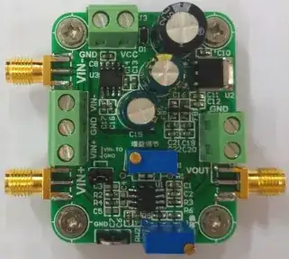

For the ad620, the bad news is that the documentation is all in Chinese. I’m translating it with deepl.com. We’ll see how far I get. I’ll post a link to the result.
I did preliminary tests using the debug configuration. I connected the generator to one input and the oscilloscope to the output as depicted in an image. It didn’t work unless I added a wire to the ground. I then was able to view expected signal and adjust gain, but the signal was a little bit unstable. Unfortunately it didn’t work with the coil. I see what looks like white noise whose amplitude doesn’t change when adjusting the resistor controlling the gain. I was expecting I would see 50Hz noise. I don’t know if I should work in differential mode or not. I tried it without success.
I have another coil connected to a 100W audio amplifier and the generator that I can use to induce a varying magnetic field in this coil. I can then use this as a reference signal and can vary the intensity and frequency. I already tried it without amplifier and I could see the signal with my oscilloscope.
Edit 2: I have translated the documentation of the AD620 module. It is available here. It contains my email for private contact if you want.
AD620 amplifier module

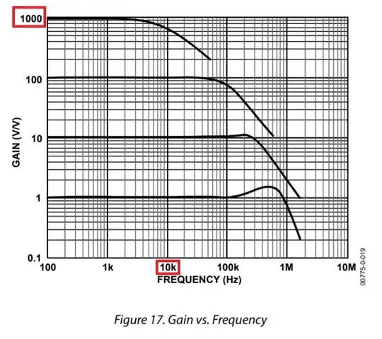

However, you should be aware of gain imposing a limitation on your signal amplitude at 10 kHz: -
AD620 data sheet.
I would consider using two devices; one as a front-end with a gain of 100 and a secondary op-amp with a gain of 100 following it. You should also be aware of the noise specification.

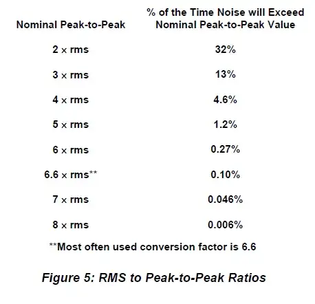

For instance, the AD620 has a noise specification (\$e_{ni}\$) of typically 9 nV per square root of bandwidth. If your bandwidth is 10 kHz then your equivalent noise bandwidth will be a little bigger at about 16 kHz. This translates to a signal noise of 9 nV x \$\sqrt{16000}\$ = 1.14 μV RMS. This is amplified by 10,000 to become an output noise of 11.4 mV RMS.
Being practical means that this will be equivalent to about 75 mV p-p: -

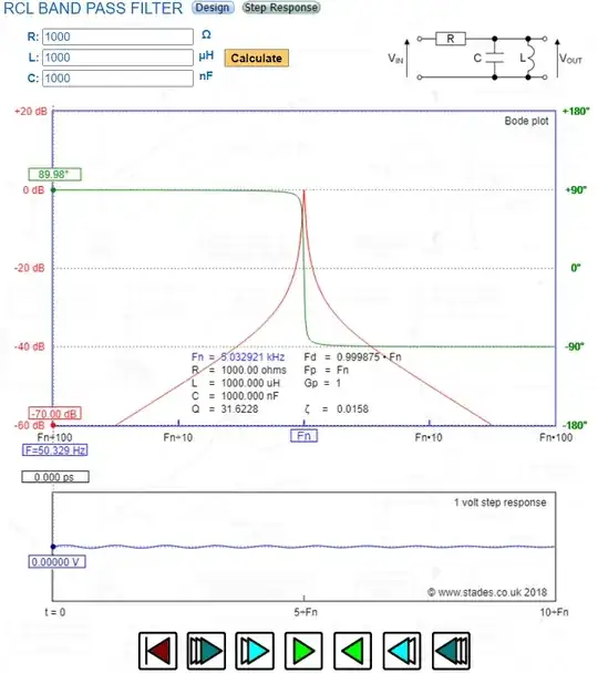

Then you could bring in the really big guns. If you know what your signal frequency is then you can apply a band-pass filter to remove a lot of the noise that might dog your measurements. For instance this circuit: -
  • R = 10 kΩ
  • L = 1 mH
  • C = 1 uF
It has a resonant frequency of about 5 kHz but it has very steep skirts like this: -
This Interactive BP filter calculator will allow you to calculate different filter values for different centre frequencies.
I estimate the noise bandwidth to be about 300 Hz and that is a significant improvement over 16 kHz previously mentioned. I reckon noise would reduce by over 7 times.
Given that I'm suggesting you to use a two stage amplification system, you should put the filter between stage 1 and stage 2. In comments I mentioned putting at the end of the signal amplifier chain but I'm changing my mind a bit. You could also use a graphic equalizer for removing out of band noise. If you have one, use one.
I would be glad to make the amplifier myself, but it doesn’t sound realistic. I would have to make a plan of a PCB card which is already a science in itself, and submit it to a factory. Then debug the card, which is also beyond my competence.
You can get an el cheapo LM358 amplifier module with a gain of 100. I believe that they might just do the job when connected to the back of the AD620 module via the aforementioned filter: -
They're not that great but it might give you enough of a positive result to think about designing this amplifier with a more professional specification.

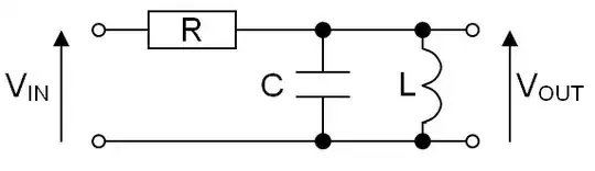

  • Thank you very much this answer. Thanks for the low pass filter schema. Should I put it between the coil and amplifier or between the amplifier and the oscilloscope ? I guess it’s before the amplification. Where could I find a low noise op-amp amplifier with a gain of 1000 or 10,000 ? There are plenty schema on the net, but I can’t build it myself. Any suggestion ? – chmike Dec 16 '20 at 17:53

  • I need to add the suggested filter to avoid "aliasing". Could you please tell me if the capacitor should be ceramic or electrolytic ? It seam that electrolytic capacity are for direct current and don’t last long. – chmike Jan 21 '21 at 17:01
  • Anti alias filters should be ceramic. @chmike – Andy aka Jan 21 '21 at 17:04
  • I had another question about the filter. There are arrows for Vin and Vout, but I don't understand which wire is the +. Is it the wire with the resistor ? I have a coaxial cable. I assume the + is the internal wire. – chmike Jan 24 '21 at 12:47
  • @chmike it's a non polarized circuit so anyway will work. Resistor on input side of course. – Andy aka Jan 24 '21 at 13:12
