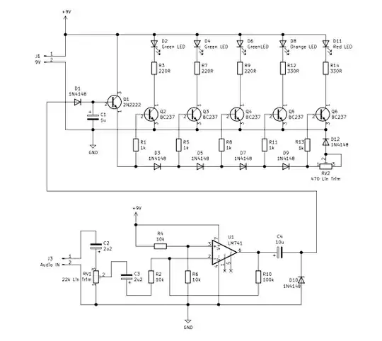

I'm currently working on a very simple mixing table, and everything works fine except that when I connect the VU meter (using a Y splitter from the master output, one end going to the audio output jack and the other to the VU meter), it produces a high pitched noise that gets into the master output. How could I fix that?
Schematic of the VU meter

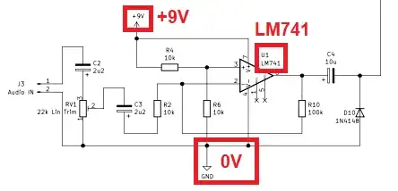

    Note that most audio circuitry involving op-amps use split supplies, such as +/-12v. This allows the AC audio signal to have a 0VDC bias, making life easier by using simple AC coupling capacitors between stages. Confining an audio signal to 0-9v means the audio signal must have a DC bias, such as 4.5V. There are many reasons why split supplies are used. – rdtsc Dec 16 '20 at 13:27

Here's a clue: -

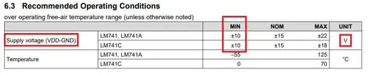

If you read the data sheet for the 1968 vintage dinosaur op-amp aka the 741 you would see this: -
If you converted to the μA741 you can run on supplies as low as +/- 5 volts: -
But, the 741 is a crock of sh1t poo really and you should be using something a little more modern.

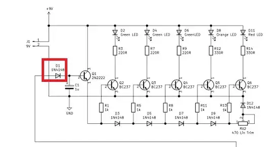

However, if you want to resolve this methodically, remove D1 here: -
And see if the problem you get is still present. If the problem is still there at least you know it's something to do with the 741 circuit.

  • It's certainly able to run from lower supply voltages and if you have one you can try it but, it's probably worth removing D1 as per my late modifications in my answer. – Andy aka Dec 16 '20 at 12:36
