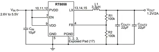

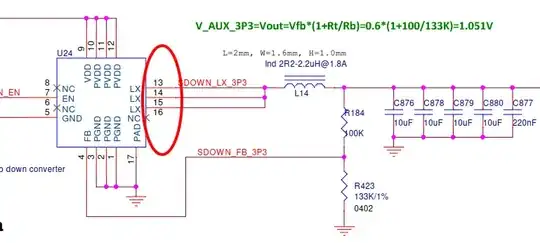

While looking at existing designs in the company that I recently started working at, I noticed many times that designers take for Example a DC-DC and add extra outputs that have the same name, and then they connect them to the same node:
This is a Richteck DC-DC that has the following Application Circuit:
What is the reason for that?
Note: Notice that the same principle here is applied for PVDD.

    Another reason on the CAD side is that the footprints (say QFN-20) will have a standard numbering on the pads (1 to 20) and on the schematic symbol you will want to connect all of them without having to have a footprint per device, so you create many symbolic pins with same name but pointing to different pads. – Wesley Lee Dec 09 '20 at 15:56

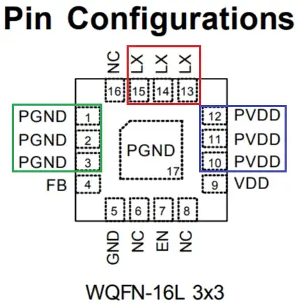

Look at the physical implementation of the device: -
  • There are 3 pins called LX (numbered 13, 14 and 15) and they all need to be joined together - reason; to maximize the current out-of the chip. They are outputs.
  • Same reason for PVdd (numbered 10, 11 and 12). This is the input power connection and multiple pins are used to maximize the current into the chip.
  • PGND is the same.
