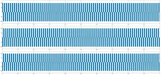

I have designed three phase inverter in ltspice with SPWM technique using mosfet switch. the output voltage at the load is incorrect. could anyone please tell me what is wrong in the simulation to get the output properly.
The expected result without filter at output end. output Current enter image description here output Voltage enter image description here

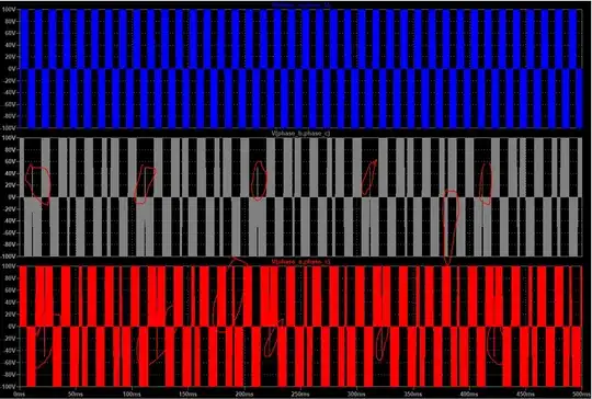

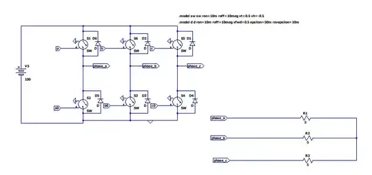

I changed the mosfet and diode to VCSW and modelled diode, with SPWM Technique. enter image description here The code for modelled mosfet and diode.

The output of the above sim files looks like below pic output voltage enter image description here output current enter image description here And I get this error in the graphs of output voltage in phase bc and ac, output current in i(r1),i(r2),i(r3) and how to resolve it?
    Please [edit] your question to explain what you expected and what you got. We can't guess! – Transistor Nov 26 '20 at 19:53
    You are connecting load to ground, however ground is not connected to halfbridges power. Put a delta configurated load and see. – fifi_22 Nov 26 '20 at 20:35
    Besides what @fifi_22 said, your drivers will not achieve their purpose. You need to drive each switch w.r.t. their sources. – a concerned citizen Nov 26 '20 at 23:03
  • @fifi i tried it with delta but it does not work – Venkatkumar Muneeswaran Nov 30 '20 at 13:30
  • @a concerned citizen can u give some sample of driver circuit for each switch please – Venkatkumar Muneeswaran Nov 30 '20 at 13:31
  • @transistor. I have three phase inverter with mosfet as a switch and spwm as pulse technique, i need to proper three phase ac output at load end? – Venkatkumar Muneeswaran Nov 30 '20 at 13:33
    You still haven't explained what you expect and what you got. – Transistor Nov 30 '20 at 13:59
  • @VenkatkumarMuneeswaran When you type the @, press TAB to cycle between the nicknames, spaces are not allowed. Also, see if this doesn't help you get started (in whatever you wish to do, you still haven't said). – a concerned citizen Nov 30 '20 at 14:23
  • Please provide us simulation file – fifi_22 Nov 30 '20 at 15:13
  • @fifi_22 @a concerned citizen. I have upload the sim file. for you reference – Venkatkumar Muneeswaran Nov 30 '20 at 18:00
  • @VenkatkumarMuneeswaran - Hi, You have already had a useful reply, in the parallel thread where you have asked the same question on Electro-Tech-Online.com. To avoid readers here wasting time duplicating effort, please update this question when you get new information elsewhere. Thanks. – SamGibson Nov 30 '20 at 18:03
  • Your drivers ground is not shared with power ground, Hi side driving will never work without level shifter. And Yes - it's difficult to implement discrete, so common solution to this is: 1) use dedicated IC (eg. IR2110) 2)use transormer with 1:1 windings. – fifi_22 Nov 30 '20 at 18:30
  • @fifi_22 where to use this IC(IR2110 is not available in LTspice) or 1:1 transformer in the circuit – Venkatkumar Muneeswaran Nov 30 '20 at 18:56
  • @VenkatkumarMuneeswaran You don't need MOSFETs here (and they already have body diode, no need to add one), you can replace them with VCSW, the way you saw in the other answer. Just use one of those schematics and add another leg in the bridge (plus a driver for it). Surely you don't expect people to do it for you? – a concerned citizen Nov 30 '20 at 19:16
  • @aconcernedcitizen i have modelled the mosfet and diode of the converter, and then even i get error at simulation please see question above again. could you please give some suggestion on this? and also ( Just use one of those schematics and add another leg in the bridge (plus a driver for it).) I am not able understand this one – Venkatkumar Muneeswaran Nov 30 '20 at 20:23
  • @VenkatkumarMuneeswaran The load is not used with ground. Move it from the load to the bottom side of the bridge. Also, there is no need for series resistors at the inputs of the switches. – a concerned citizen Nov 30 '20 at 21:14
  • @aconcernedcitizen still the simulation stops at 0.010012seconds and creates a trouble.. can you please see the updated question and suggest a solution for the problem. – Venkatkumar Muneeswaran Nov 30 '20 at 21:21
    I had practical implementation in mind. There IS ir2110 model for ltspice on the web. These should be used to drive hi/lo mosfet gates. – fifi_22 Nov 30 '20 at 21:39
  • After all the comments and solutions handed over to you you stil expect people to do your job and debug the circuit for you? Not only the last uploaded source doesn't have the changes I told you to do, your error takes literally 5 seconds to find, but I won't say what. I shouldn't even have responded. And neither should have the others. You are unbelievably lazy. I rarely downvote, but for this, -1. – a concerned citizen Nov 30 '20 at 23:09
You need to move the ground from the load to the bottom side of the bridge. Replace all occurences of td=10n Vhigh=15 with td=30n tripdt=100n. Delete all the remaining Vhigh=15. Optionally, delete all the resistances from the inputs of the switches, they are useless. Now it should run. BTW, you have a stale gate in the upper side of the schematic.
