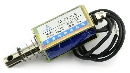

I am wondering how long you would expect a standard electromagnetic solenoid like this to be able to be switched on? Any first hand experience would be appreciated.
Image of solenoid from the Amazon link
If there is no data on this - is it safe to turn it on and wait until it heats up? And then use just under that time for the future? In other words - if it doesn't get noticeably hot, does that mean it is fine to run it that long?

Solenoids like this in data sheet should have two different value of current. For move, current bigger, for hold, smaller. your example don't have those parameters. Ask the seller. If it is made not for commercial or industrial use, there is only way to find out is experiment.
