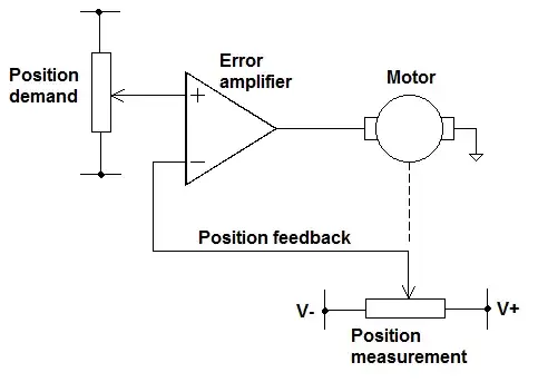

Forget about op-amps for a couple of minutes and think about a servo control mechanism like this one for example: -
You set a "position demand" with the potentiometer on the left and, the error amplifier "calculates" the voltage difference between "actual_output" (from the position measurement potentiometer) and "position demand". That difference signal drives a motor (a highly non-linear device) to move its shaft in the correct direction and, the "calculated error" reduces accordingly.
As the output from the error amplifier gets smaller, the drive to the motor reduces and, eventually, the error between demand and output position is too low to drive the motor any more. It's an imperfect control system because of motor non-linearities and "real world" problems such as mechanical linkages, stiction and imperfect potentiometers.
If the error amplifier used a significant amount of gain to amplify the error signal then, the final static error reduces and, the output quite accurately matches the input demand. Despite all the real-world non-linearities and imperfections, when you have a decent gain in the error amplifier, you get a decent correlation between input demand and final position.
It's the same formula as the op-amp and has got nothing to do with large or small signal analysis - the gain of the error amplifier drives the system (via negative feedback) to make output equal demand: -
$$V_{\text{output potentiometer}} = V_{\text{demand potentiometer}}\cdot\dfrac{A}{A+1}$$

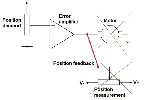

And, all an op-amp circuit does is bypass the motor and output potentiometer like this: -
Image of control system from this answer.
