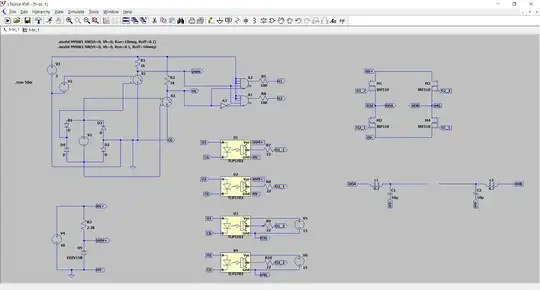

I was Following this tutorial to make H-Bridge. I have first did some simulation and the following image shows the same.
I don't have schematic because I directly made the circuit by hand based of the simulation.
The problem that I am having is that without having any load the output of H-bridge is a square wave and not a sine wave as apposed to the simulation.
Infact, the person in the tutorial was also having the same problem but he solved that by connecting a load at the output (please visit the link to see the problem).
Can you explain why do we get square wave instead of sine wave
the following is the LTSPICE file

Sanmveg saini
  • 571
    A schematic is needed (not slightly needed or a bit nice to have; it is needed). – Andy aka Nov 18 '20 at 10:58
  • Please add a schematic but NOT a raft of huge photos that create a major scrolling headache and a hard-to-follow question. – TonyM Nov 18 '20 at 11:08
    Voltage is square , but current is not. Try to connect resistive load and measure drop voltage. – user263983 Nov 18 '20 at 12:12
  • How are you generating the PWM control input? Make sure the schematic shows us that. If it's software, have you checked it independently of the 220V bridge? –  Nov 18 '20 at 14:53
  • @Andyaka please look have a look at this now. – Sanmveg saini Nov 20 '20 at 14:19
    @Sanmvegsaini Posting the source for the schematic is encouraging, but you're using custom libraries, in particular TLP5702 (both symbol and subcircuit). People that don't have your files can't run the schematic. However, looking at the connections, it's difficult to decipher what you're doing, but judging from the looks of it, all you want is to see the effect of a filtered SPWM. In this case, maybe this answer will help you. – a concerned citizen Nov 20 '20 at 14:56
