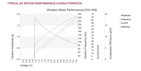

You may not be able to find data on that part, though if you do need to use it in an "unusual" mode you might search for a part that is specified for that service.
For example, here is a datasheet for a similar device.
The only specifications given are that the current is guaranteed to be 80mA or less at 3.0V, recommended operating range is 2.5 to 3.5V and it is guaranteed to start as low as 2.3V (but only if you step the voltage to the motor, you're not allowed to sneak up on the voltage). That has probably been adequate information for them to sell millions of the devices at very reasonable prices.
If you are willing to pay a "bit" more Precision Microdrives offers a similar sized product with these typical performance characteristics:
It is anyone's guess whether those curves bear any similarity to the Amazon product or the Seeed product. There are also no guarantees, but it should give some rough idea of how it behaves.

  • "Typical" data is useless unless you know the tolerances either side of "typical". – alephzero Nov 13 '20 at 16:17
  • @alephzero For analog parts you usually don't have guaranteed tolerances from the manufacturer except at a few points, and often you only have minimums or maximums guaranteed even there. The usefulness of the typical data shown above is that it tells you the motor will stall below some particular voltage, and above that voltage the current, frequency and amplitude increases more-or-less linearly. That helps in interpreting the guaranteed starting voltage. Where one can get into trouble is if one assumes that it will start at the 'typical' voltage or that the curves are quantitatively accurate. – Spehro Pefhany Nov 13 '20 at 16:41
