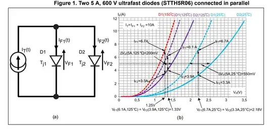

In parallel, the drop will stay the same (reverse leakage and capacitance will add), but the current capability may not be much higher, due to the possibility of thermal runaway (since as a diode gets hotter it's Vf drops, then it draws more current relative to the rest, gets hotter still, and so on). You can avoid this somewhat by placing the diodes in thermal contact with each other, and/or using a small resistor in series with each.

Diodes in parallel:
Diodes are frequently connected in parallel in switching power supplies in order to share the current. Here is a document on "Current sharing in parallel diodes".
Diodes in parallel
Thermal Runaway really depends on the diode package and the heat-sink (dissipation) that they are mounted on. The diode in my hand right now has a maximum Tj of 150 C (Vishay STPS30L60CW-N3). Provided enough dissipation in the design, the design can deliver higher current in "diodes in parallel".

https://www.daenotes.com/electronics/basic-electronics/diode-in-parallel
In a parallel connection, diode with the lowest forward biased voltage drop will try to conduct more current causing Thermal runaway.
Diodes in series with the same polarity each behave no differently than a single diode. The voltage drop and current capabilities of each diode remains the same. The overall voltage drop of the series combination of the diodes will be equal to the total of all of the diode voltage drops. The current capability of the diodes does not change.
Diodes in parallel with the same polarity each behave no differently than a single diode. However, due to the fact that the current into each diode is lower because of the current divider rule, each diode will have less current flowing through it, and therefore its voltage drop will be lower, as this is a characteristic of diodes. Therefore, assuming the diodes are all very similar in Vf, the overall voltage drop of the parallel combination of diodes will be lower than it would be for a single diode. Although each individual diode's current capability does not change, the parallel combination of diodes can handle more current overall, once again because of the current divider rule.

    If the world was ideal sure, however 2 diodes will never perform exactly the same even if heatsinked together so they won't current share exactly 50/50... meaning the combination of two diodes will always handle less than 100% more current than a single. – cb88 Sep 24 '18 at 15:14
  • Not sure what point you are trying to make. You are correct about "less than 100% more" (obviously) - but I never stated otherwise. – GGBB Sep 25 '18 at 23:48
  • Because someone that didn't know better might assume based on they way you have it written that due to reducing the load on each diode you can actually get to 200%+ load.... instead of a more likely senario of something like 150%-190% depending on how well they are heatsinked together and differences in the diodes themselves. Because "assuming the diodes are all identical" just plain isn't a valid assumption. Also the voltage drop will not be lower... Diodes aren't resistors!? It will be some non linear function of the two, favoring whichever diode has the lowest drop. – cb88 Sep 26 '18 at 14:09
  • I think you need to look into it a bit more. The voltage drop will in fact be lower. Watch the video I linked. As forward current across a diode goes down, forward voltage also goes down (data sheets show this). Instinct might tell you that only one diode can be "on" because it will have a slightly lower Vf, but turn-on is never instantaneous - it is gradual, and I think that's what's at play here. So more than one diode can and will be "on" at a time assuming they are close in Vf - which is what I meant by "identical" (a poor word choice I agree). I've breadboarded this for myself - try it. – GGBB Sep 27 '18 at 23:51
  • That's only if you hold current constant. If you double the current you're back at square one voltage drop wise. And that was my point you'll never get to 100% more current conducted. – cb88 Sep 28 '18 at 14:47
  • Did you watch the video? Voltage drop goes down just by paralleling the diode. That's my point. – GGBB Sep 29 '18 at 17:37
