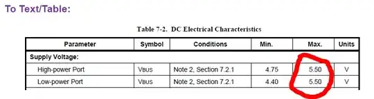

According to USB-IF updates, "USB 2.0 VBUS Max Limit ECN as of August 11, 2014", the allowed VBUS voltage is now 5.5V. See latest release of USB 2.0 specification with all ECNs. Old poorly-designed devices may have difficulty to handle the 5.5V input.
The ECN mandates the following change to Tab.7-2 of USB 2.0 Specifications, plus corresponiding changes in several related places: enter image description here

  • Hmmm, quite an interesting tidbit. Thank you for sharing! I assume this also applies to USB 3.0 (and its numerous iterations). So, even though it is a bit higher than preferred, it's still (theoretically) safe. The oldest device connected to my hub is about 10 years old, a USB 2.0 Seagate drive, and it's been working fine this whole time. :-) – leetbacoon Nov 14 '20 at 08:37
  • @leetbacoon, this is not a "tidbit", it is a normal legal process of amending aging specification with progress in technology. There are many ECNs, if you have time to download the spec and corresponding ECNs. And yes, the USB 3.x specs does include the change to 5.5V as well. These ECNs even have explicit warning: "New designs adhering to this ECN will need to consider the new 5.5V VBUS max level during the component selection process." Many old designs did use internal linear regulators to 3.3V with max input voltage of just 6V. – Ale..chenski Nov 14 '20 at 09:13

  • You need to follow USB-IF updates to USB 2.0 specifications more closely. Since 2014 the VBUS is allowed to be 5.5V. – Ale..chenski Nov 14 '20 at 07:59
  • @Ale..chenski thanks for the heads up. This increased voltage tolerance won't apply to the OP's devices which pre-date 2014 being 7 or 8 years old. – mhaselup Nov 14 '20 at 08:37
