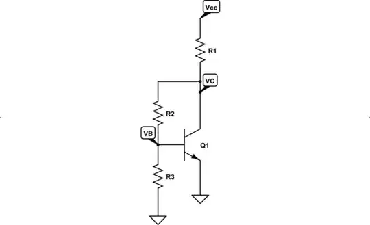

This is a quick drawing of a circuit that I am trying to analyze. Basically, I want to know how to go about finding the collector current, to start. Is it possible to create a Thevenin equivalent circuit for the resistors in this model? If not, how do I start on finding the voltages?

There is a schematic editor and you should use it. It makes things a little easier for the rest of us. Here's your schematic:
schematic
From your problem statement, you already know that \$V_\text{B}=500\:\text{mV}\$ and \$\beta=50\$. You also know all three resistor values and \$V_\text{CC}\$. So in this case there are only two unknowns to solve for.
From KCL, find:
$$\begin{align*} \frac{V_\text{B}}{R_2}+\frac{V_\text{B}}{R_3}+\frac{I_\text{C}}{\beta} &= \frac{V_\text{C}}{R_2}\\\\ \frac{V_\text{C}}{R_1}+\frac{V_\text{C}}{R_2}+I_\text{C} &=\frac{V_\text{CC}}{R_1}+\frac{V_\text{B}}{R_2} \end{align*}$$
Just solve those for \$V_\text{C}\$ and \$I_\text{C}\$.

Using sympy for a symbolic solution, I need declare some symbols for the above equations. So, I just write:
var('ic beta vcc vc vb r1 r2 r3')
That tells the software that I'll be using those names in what follows.
Then I write out the two equations:
eq1 = Eq( vb/r2 + vb/r3 + ic/beta , vc/r2 )
eq2 = Eq( vc/r1 + vc/r2 + ic , vcc/r1 + vb/r2 )
Simple inspection shows they match my earlier equations.
Then I just ask it to solve this for me:
ans = solve( [eq1, eq2] , [ic, vc] )
At this point, I could just print out ans and get the symbolic equations that resulted from the solution. But it's not necessary. I want the numerical results. Here, I will need to supply the values for those earlier variables. But that's easy:
for x in ans: x, ans[x].subs({r1:10e3, r2:100e3, r3:33e3, vcc:10, beta:50, vb:.5})
(ic, 0.000642076502732240)
(vc, 3.29930452061600)
Without sympy, but using SageMath instead, you don't get fully symbolic solutions. But you can get numeric ones. In this case, you'd just write out the equations with the known values filled in:
var('ic vc')
eq1 = .5/100e3 + .5/33e3 + ic/50 == vc/100e3
eq2 = vc/10e3 + vc/100e3 + ic == 10/10e3 + .5/100e3
solve( [eq1, eq2] , ic, vc )
[[ic == (47/73200), vc == (13283/4026)]]
In this case, you get the exact fraction result instead of a decimal value.

  • a nice concise solution @jonk with simpy for Vc=3.3 was pretty close to my mental calculation of 3.6V using vb=0.58 whereas you used .5 Tolerances on hFE and far greater than resistors but this design can be improved with a fixed source Rs added so as not to have the inaccuracies excluded for AC gain, not asked. – Tony Stewart EE75 Nov 02 '20 at 00:06
This is one of the preferred ways to design a Common Emitter with feedback.
When you desire a Vc=Vcc/2 you get 0.5mA. A universal constant for BJT’s is 0.6V @ Ic=1mA so Vbe will be slightly less, say 0.58V ( guesstimate)
But simply using 0.6V you can get a simple voltage divider for Vbe with 33k/(33k+100k) x 5V = 1.24V the Thevenin equivalent voltage open loop then Req= 100k//33k= ~ 25k so the base current = 1.24-0.6V/ 25k~ 26uA and Ic=50 x 26uA= 1.3mA. (Ignoring Vcc and closed loop)
This tells you your initial assumption is wrong at Vc=Vcc/2 so you can iterate or change Rc to a lower value to get 5V or use a more lengthy rigorous KVL calculations.
however it is worth noticing that in a Negative feedback mode the source impedance would be likely a capacitor whose impedance at f is known and with the low hFE you might get half of the ratio of Rf/Zc(f) =Av so the prudent concept is to use a series Rs of desired Av*2=Rf/Rs
So for Av=100 choose Rs and add a large cap and Rs=1k/2 Ohms which adds to Zc(f) as a HPF and the ratio of 200 gives a gain near 93 and Vc ~ 3.6V but I’ll let you do your homework.
However choosing. Gain >200, is pushing it and source impedance comes into play for a small signal source and is unlikely to be that low. You might get >200 with a 0 ohm voltage source or may a 50 Ohm gen but preamps are often higher source Z. So keep that in mind with a Negative feedback circuit. To
if you balance the Vce to mid-scale you can almost get full scale undistorted output ,save Vce(sat) which depends on Ic! This make the primitive H bias or simple half H common emitter amplifier obsolete except for apps that demand very high input impedance as the input impedance is reduced by the feedback gain.
achieve with low hFE but you may get close a gain of half of this ratio or 100 with excellent low THD. (Within 10%)
This is my method of doing it in my head, but your Prof may want you to use the rigorous method, which is a bit useless since hFE tolerances are about 50%.
Although I digress, when you increase the collector current reducing Rc=10k to say 7k, Vbe rises to 0.6V and the open loop gain of Rc/rbe reduces and then your Rf/Rin ratio drops to about 1/2 x 80% for Av.
@Jong can give you an eloquent long hand solution, but this works for me.

Consider the base current Ib and the collector current Ic. We know that Ic=50Ib, so 51Ib will flow through the 10k resistor. This comprises three components: firstly the current through the 100k and 33k resistors (Vc/133k) secondly the current flowing into the base ((Vc-0.5)/10k) and thirdly the collector current which is 50Ib. That gives you a couple of simultaneous equations to solve for Ib.

Just two KCL on V_Base and V_collector and you should know: Ic=(1+Beta)Ib and V_Base = 0.5V
two KCL are: (Vc-10)/10k + ic + (Vc-0.5)/100k = 0 and 0.5/33k + 1/((1+50)*ic) + (0.5-Vc)/100k = 0
