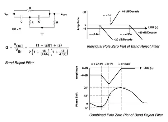

Here is a band reject filter with its transfer function and bode plot. I don't understand how the pole frequencies and zero frequencies are drawn on the bode plot. Even with the pole and zero frequencies given, the math in the transfer function didn't come out to be correct.
According to definition, a pole is when the denominator is zero and the transfer function approaches to infinity, and a zero is when the numerator is zero where the function approaches to zero. So to determine the frequencies for poles, I set the denominator to 0:
\$ 2\big(1+{\tau s \over 0.44}\big)\big(1+{\tau s \over 4.56}\big) = (2.0064-\tau^2\omega) + (5\tau \omega \hat j)\$ =0
where the first bracket is real and the other bracket is imaginary. There is not one frequency that can possibly make both the real and imaginary part of the algebra to be zero!
The book gives pole frequencies at \$ 0.44 \over \tau \$ and \$ 4.56 \over \tau \$. If I choose \$ 0.44 \over \tau \$ and plug that into the denominator, then what is in the bracket of \$ \big( 1+ {\tau s \over 0.44} \big) \$ will just be \$ (1+1\hat j) \$, not a zero either.
And for zeros, if I plug in \$ \omega = {1 \over \tau} \$ to the nominator, I'll end up with \$ (1+\hat j)(1+ \hat j) = 2 \hat j\$ and that's not taking the transfer function to approach zero either.
So how do \$ 0.44 \over \tau \$ and \$ 4.56 \over \tau \$ come out to be the pole frequencies, and why is \$ 1 \over \tau \$ the zero frequency? None of these frequencies take the transfer function to infinity or zero.

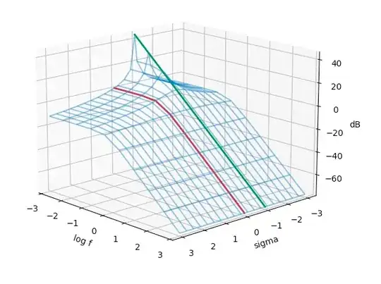

Have a look at this plot for a low pass transfer function:
What you see is the magnitude of the transfer function, |G(s)| in dB, for a single pole at s=-1.
It is drawn as a 3D surface (or wire) plot, because G(s) has a 2 dimensional argument: the real part of s (sigma), and the imaginary part of s (omega, or 2pif):
  • The red line shows the Bode plot |G(f)|, obtained by setting s=jw in G(s). Notice the knee at around f=1.
  • The green line is G(s) plotted along sigma=-1. As it approaches the pole at f=0 it keeps climbing at a constant dB/log(f) slope. Because the horizontal axis is log(f) of course the plot will never reach f=0 where |G|=inf.
The knee on the red line is called the cut-off. It's NOT where the pole is. The pole is at w=0 along the green line. The knee location depends on the distance of the pole from s=0. The two are related: the knee is determined by the sigma of the pole, but the pole itself is not at the knee.
If all poles are in the left half-plane, you can obtain the the Fourier transform by setting s=jw, and that provides you with the familiar G(w) (or G(f)) transfer function. Often G(s) is provided, and G(w) is plotted.
G(w) is not identical to G(s), but in practical analog design cases, as in your case, it is the same; not just approximately or practically, but also theoretically.
Here is another nice plot example of G(s) with complex s, and it includes a plot for G(jw). This is not your case, but it shows how a pole in the s-plane influences the transfer function along jw.
Notice the "circus tent pole" at sigma<0. That's where the response is infinite. But along the red s=wj line it's a familiar high-pass. As you move the pole closer to the jw axis, i.e. as you move sigma closer to 0, the pole will become more pronounced. In many filter designs (Bessel, Chebyshev...) the many poles are carefully placed at various distances from the jw axis and at varying frequencies, to get overall flat responses and deep attenuations.

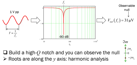

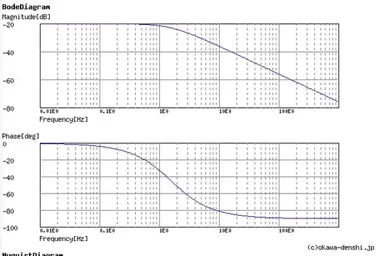

Here's an example of a single pole transfer function:
As you can see, a "pole" does not mean "infinity" in the transfer function for s=jw, i.e. for stationary sinusoids.
Calculator at: http://sim.okawa-denshi.jp/en/dtool.php
Entered data: enter image description here

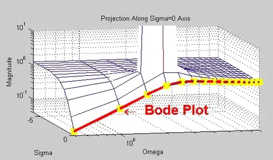

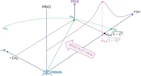

I can see you are struggling with this so here's a 3D view of example pole positions along with the bode plot (on the jw axis): -
Note that your TF will produce two poles along the \$\sigma\$ axis at negative values.

    Maybe the OP needs a link to the answer you gave with the beautiful 3-D plot of a transfer function showing the jw axis, sigma axis, and frequency. – John D Oct 29 '20 at 16:54
  • Good call John D. @KMC here's a link to another answer that should give you the lowdown on why the actual poles exist but don't exist along the jw (bode plot) axis. If for your circuit the poles aligned with the jw axis then you would have infinite gain in parts. – Andy aka Oct 29 '20 at 16:57
  • Sorry, not following here. I understand if $ s = - {1 \over a} $ the 1's cancel out and equate to zero - in your answer you're allowing s to be negative. But in my question, the pole frequency is given as positive $ 0.44 \over \tau $, plugging into $ 1 + { {\tau s} \over 0.44 } $ yields $ 1 + 1 \hat j $ which has magnitude of $ \sqrt {2} $ – KMC Oct 29 '20 at 17:46
  • The actual pole frequency may be regarded as equivalent to a positive jw value but that is its equivalent magnitude and that can be projected in any direction; in the pole zero domain it will have co-ordinates that have a real negative value and a zero jw value. – Andy aka Oct 29 '20 at 17:55
  • I am lost absolutely and entirely. The pole is $ 0.44 \over \tau $ - a 100% real number. I plug that into the equation and it didn't come out to be zero. The pole given is not a complex number and shouldn't be - it is a physical number that I can physically insert into a function generator for example. Frequency has to be real. – KMC Oct 29 '20 at 18:16
  • A real number in the pole zero diagram doesn't mean it's real along the jw axis. Yes it's confusing - actual reality (ie a spectrum or bode plot) exists along the jw axis and not the real axis. So you can't use the co-ordinates of the pole ($\sigma + j\omega$) and align it exclusively with the jw axis. – Andy aka Oct 29 '20 at 18:42
  • @Andyaka I'm not getting any implication from this multidimensional graph. It's pure obscurity to me. Bode plots are 2-D plot of frequency vs log of voltage ratio, and a 2-D plot of frequency vs. angle. The frequency is so real I can type into a function generator. The angle is a measurement I can measure on an oscilloscope. What is jw axis? What are $ \zeta $ and $ \rho $? Why is the pole offset from where max gain happens? I sure I'm missing a big piece of knowledge to understand your answers but I don't know what that is... number theory? control theory? – KMC Oct 30 '20 at 14:24
  • As soon as you start talking about poles and zeros the frequency is along the jw axis. So, you probably need to brush up on basics of pole zero diagrams before you'll understand the answers. – Andy aka Oct 30 '20 at 14:30
  • Nice drawing, Andy. Now that I look at it from the perspective of the OP based on how the discussion is going, I think it might be a bit confusing. The drawing is for conjugate-complex poles, where the pole's jw is close to the cut-off. But in the multiple single-pole TF of the OP, the poles are at w=0, and knees show up in a Bode (log-f/dB) plot. The TF at 1/2 matches the pole's sigma (not jw), which is admittedly harder to visualize and not intuitive. But would you care to update it? – P2000 Oct 30 '20 at 14:48
  • And I should update mine too. – P2000 Oct 30 '20 at 14:53
  • @P2000 no, not really. It's an example diagram with notes underneath stating that in the OP's example the poles are along the negative sigma axis. – Andy aka Oct 30 '20 at 14:54

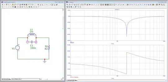

It is a recurrent question, "why I can't see the magnitude going infinite with a pole and zeroed-output with a zero"? If we take the example of a zero, you can certain go to the lab and build a small \$RC\$ filter featuring a pole and a zero as below. But if you excite this network at a frequency tuned at the zero frequency, still a signal is observable as a response:
The reason is because the zero located at \$\omega_z=\frac{1}{r_CC_1}\$ is actually the modulus of a negative root \$s_z=-\frac{1}{r_CC_1}\$. When you excite the network with a sinusoidal waveform, you perform a harmonic analysis which is equivalent of exploring the imaginary axis only which naturally excludes the negative parts where the root \$s_z\$ is located. Therefore, with a sinusoidal excitation, your stimulus cannot produce a frequency described by \$-\frac{1}{r_CC_1}\$.
There are specific cases though when the roots are naturally located in the imaginary axis. Having a dc block capacitor places the zero at the origin, meaning there is a root for \$s=0\$. Set the stimulus to a 0-Hz frequency - a dc voltage - and you will observe 0 V as a response:
For the zeroes, if you build a high-\$Q\$ notch, meaning the damping is almost inexistent, then the zeroes are located on the vertical axis \$s=j\omega\$ and your sinusoidal stimulus properly tuned will cover these zeroes. In that case, the response is truly a null as shown below:
You can extend this approach to poles for instance: build an integrator around an op-amp featuring a pole at the origin and if you bias the input with the same 0-Hz frequency and a very small value, you'll observe a very large value limited by the op-amp open-loop gain and later clamped by the op-amp railing up. Same with an undamped \$LC\$ filter: the poles are close to be pure imaginary (assume an inductor with very small resistive and magnetic losses and a cap. with a negligible equivalent series resistance) and a small stimulus tuned at the double pole frequency will generate a very high voltage.
Using this technique is the basis of the fast analytical circuits techniques or FACTs described in an APEC seminar I taught in 2016.
