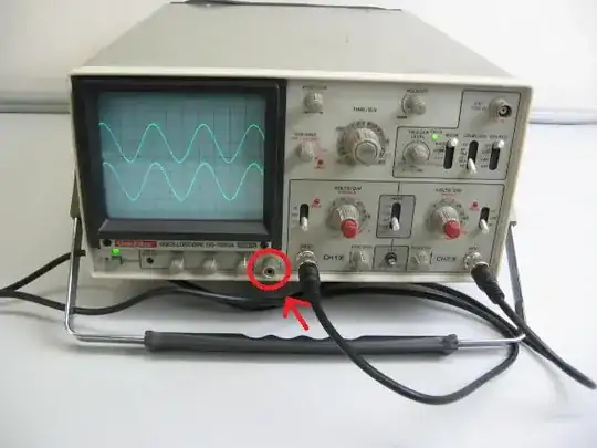

I just bought my first analog oscilloscope (GoldStar OS-7020A) and noticed it has a port on the front labeled "ground". What exactly is this port for?
I thought it might be for plugging in a ground clip for probes that don't have one included, but there are two channels and only one ground port, so I'm not sure. Is it simply for providing a convenient ground connection for other devices?
Could I, for example, attach my anti-static wrist strap to it? Would the oscilloscope have to be on for that to work? (Electronics newbie here, so please forgive me if this is a stupid question.)

Most oscilloscopes have a safety ground. This connects to the earth ground on the plug and also to the case. The thinking is if you wire it up wrong worst case you trip the GFI/RCD instead of shocking yourself or damaging the instrument.
As an oscilloscope is usually a bench instrument it is not isolated from the mains. You can use an isolation transformer, but this is not recommended, as it removes this protection leaving the earth ground floating.
Tektronix sells an oscilloscope which has fully isolated inputs, I don't know of any other models. It is significantly more expensive to add high speed isolation circuitry. Usually it means the whole analog and acquisition side must be isolated.

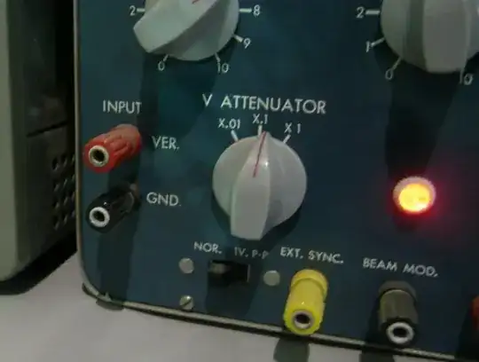

Once upon a time, coaxial cables and connectors were not so common and cheap, and the frequencies of interest were lower. Oscilloscopes had terminals for individual wires, or banana plugs, such as the binding posts on this unit:
Heathkit IO-12

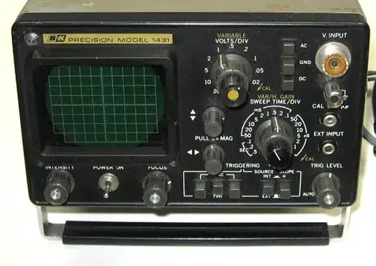

A later development was the SO-239 or “UHF” coaxial connector. One of the properties of this connector is that it can accept a banana plug. Therefore, if the scope has a SO-239 connector paired with a ground banana jack, it can accept either a coaxial or pair-of-banana-plugs input. An example of such a scope is the BK Precision 1431; note the jack and binding post in the upper right corner, with the same-sized center holes:
BK Precision 1431

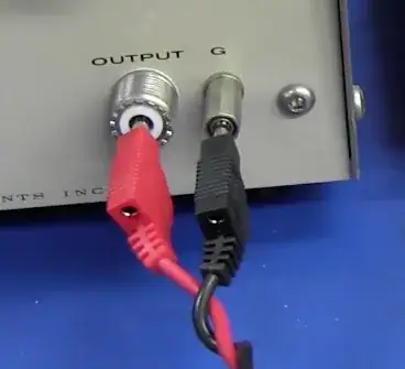

Here's a recent example of such a connection (not to an oscilloscope) actually in use, from one of Dave Jones (EEVBlog)'s videos. (This is a bit of a silly example, since the cable he's using is actually coaxial at the other end, but it was probably handier than digging up an adapter. SO-239/PL-259 is fairly uncommon if you're not an amateur radio operator.)
Two banana plug wires inserted in a SO-239 and binding post.

That terminal is the case-ground of the oscilloscope.
Assuming your oscilloscope is using a three-pin plug, it is connected through the device's power-cord to ground.
It's generally used for controlling your ground-current routing, when you are trying to make high-precision measurements, which normally involves an isolation transformer (or several).
Assuming your bench is properly grounded, I don't see any issue with connecting your anti-static wrist-band to it. Do make sure that there is some resistance in the cable for your wrist-band, (I think ~1MΩ is common).
Otherwise, you will not only potentially damage anything with a static charge (you need to bleed off a static charge slowly), but in the case of any incident where you accidentally contact a high-voltage, through you you will be the shortest path to ground.
For what it's worth, you can use the oscilloscope's internal power supply as a poor-man's isolation transformer by cutting the ground lead on a power cable. This causes the whole scope to float, electrically, so you can measure with the scope-ground connected to a voltage rail without grounding the rail.
However, be extremely careful if you do this, as any fault on the non-isolated side of the scope's internal power supply could cause mains voltage to be applied to the scope local ground (and through this, your device, and potentially you).
I've done it, but it's kinda one of those areas where, unless you know enough to understand the risks (and therefore would not be asking this question), you should probably use a proper isolation transformer if you wind up needing one.
