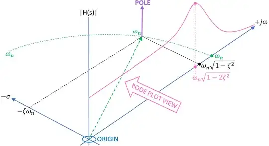

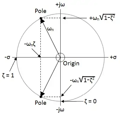

This pole zero diagram: -
Tells you everything about the transfer function and it also tells you everything about what the bode plot will look like. It's just a plan view of this: -

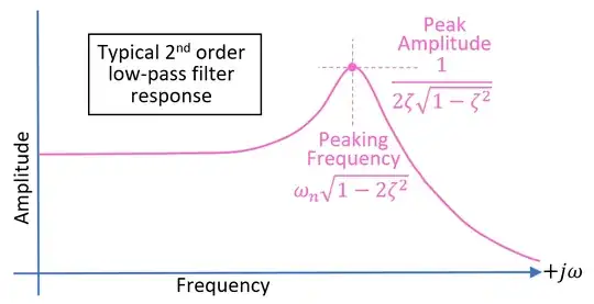

You cannot always (or even accurately) reverse the bode plot i.e. this: -
Into the pole zero diagram (top picture in this answer).
