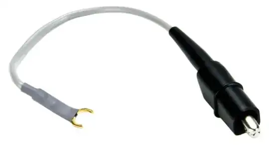

I am getting a difference when I measure the voltage using an oscilloscope and using a multimeter in the order of 10mV and in some cases 100mV. I am using a ground clip when I use the oscilloscope as shown below. What might be the reason for the difference for this?
Question 2 :
Suppose I measure voltage between two points (both of which are not ground - differential voltage) using an oscilloscope, is using differential voltage probe the only way to measure the voltage between those two points (both are not ground,) or can I use a single probe with the ground clip (shown below) to measure the voltage between those two points (both are not ground) - Is it safe?
