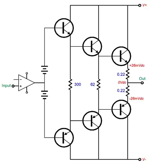

I am reading online about discrete audio amplifiers. I have learned about the input differential pair, the voltage amplifier stage, and now I'm learning about the output stage. I have learned that you want to bias the output to have about 25mV to 26mV drops across the emitter resistors as this will reduce distortion. But I have not found any information on how to bias the drivers and pre-drivers that come before the final output transistor pairs. I'm not refering to using Vbe multipliers, I'm asking how do we select the emitter resistor and current for the driver and pre-driver transistors? I was thinking that maybe the quiescent current through the driver should be the max current of the output divided by the beta of the output transistor but I can't find info on this. Maybe I'm looking in the wrong places or doing the wrong search keywords. I have attached an image I found online as refenrence where you can see the resistors in question. In this case they are 62 ohms for the driver pair and 300 ohms for the pre-driver. Any info would be helpful thank you.

Thank you for your answer. I'm not sure if I understand but I believe you are talking about the emitter resistors of the output transistors. The 0.22 ohms of the picture in the question. I was asking about the resistors of the driver and pre-drivers. Sorry if I misunderstood your answer. Edit: Question: Are you saying that if, for example, the output transistors have a beta of 50 and the driver has a beta of 100. Then, the emitter resistor of the driver should be 50 times larger than the emitter resistor of the output? – johnny24 Oct 09 '20 at 23:10
