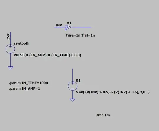

Now I tried different approach to generate squares:
  • use a sawtooth voltage source
  • use a b-source as a comparator
  • or, use some Schmidt triggers with proper thresholds across sawtooth

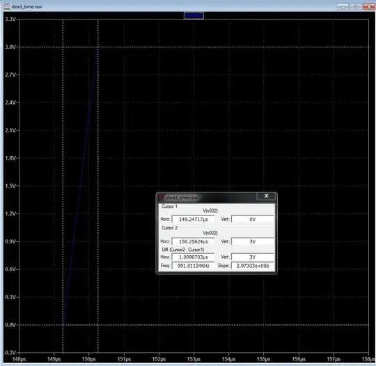

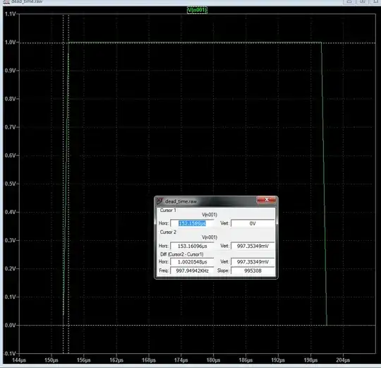

This is working, but for some reason, both Schmidt and B-Source presents a 1usecond rise/fall on generated square wave. I don't understand where it comes from.
For Schmidt I tried to set Rise/Fall near zero (1 nanosecond) but has no effect, still I measure 1 microsecond on graph.
This is output of Schmidt trigger:
This is output of B-Source, the same story, 1 microsecond rise/fall:
Any clue from where this rise/falltime comes from and how to shorten it?

Then you used a Schmitt trigger and a behavioural source as a comparator. The Schmitt trigger is part of the A-devices, which are the ones I would recommend over anything else when it comes to switching waveforms. This is why:
Behavioural sources are meant to be the Swiss knife of the SPICE world. They can take virtually any (real valued) function and use it in a simulation. The downside is that all this heavy math is a burden for computation. When the expressions are simple, they work very well, otherwise they need tweaking, and LTspice provides two temporal parameters that can help: tripdv and tripdt. What these do is they set a value for the voltage, current, or power (the ordinate) -- tripdv -- and one for the time (abscissa) -- tripdt -- which determine that any change lesser than tripdv in tripdt seconds forces the timestep to slow down and calculate the minutiae. If there is a change greater than tripdv/tripdt, the timestep is no longer constrained and the simulation runs as if there was no imposed timestep. If these two are not specified, then the simulation doesn't stop to "inquire" what happens when sharp changes occur, relative to the timestep, and the dynamic range is affected (though there are some default values for them, the result is the same in most of the cases). It translates into what you saw: microsecond edges, despite the apparent sharpness a boolean expression might imply.
So, while the above can help, using boolean expressions comes with a different problem: discontinuities. These are not simulator-friendly because the derivative has sudden jumps and these can cause the engine to stop with timestep too small errors.
There are various solutions, I won't go into details, but I'll say that the much better (in fact, the best in this case) alternative would be the A-devices. This is because they were built with switching in mind. And for this, they have a lot of temporal aids that can trully shine. They don't have tripdv, it's probably considered unity due to the default logic levels, [0,1] V, but they have tripdt, whith the same meaning as for the behavioural sources: any change that happens in less than tripdt seconds forces the simulator to slow down and show more details; elsewhere, no constraints. But, in addition to this, there is also tau, and tau plus tripdt are very powerful: tau causes a 1st order rise/fall, while tripdt ensures that this is smoothly calculated and displayed, resulting in a smooth variation of the output, thus convergent-friendly, and fast switching due to tripdt.
What you used are trise and tfall. These cause the output to linearly rise or fall, but without tripdt they are treated just like in the behavioural source's case, which is what you saw. If you aded tripdt=1n, for example, you would have seen 1 ns rise/fall edges. There is a choice that has to be made, though: only one of [tau], [rout, cout], [rhigh, rlow, cout], [trise, tfall] can be used at a time. The 2nd and 3rd are the equivalent of tau.

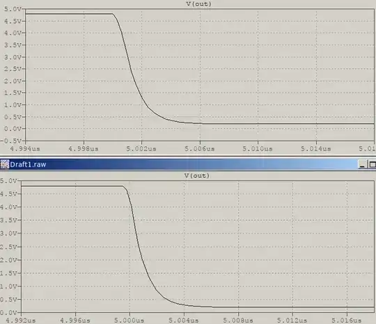

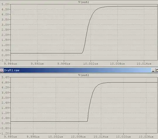

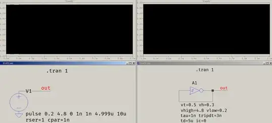

Here are two examples of having a 100 kHz switching waveform over 1 s. Since you didn't specify the pulse width, I just assumed it to be 0.5, so I used a single Schmitt inverter as an oscillator. Both run fast, preserve the resolution of the pulses, and have approximately the same shape (note: no imposed timestep):
no timestep
rise
fall

What's the maximum timestep value you have set up in LTSpice - it needs to be maybe 10 ns to get the response you want. If you leave any PSpice simulator to "do its own thing" it will take shortcuts in the analysis in order to render a quicker result.
Well my best guess is what I've said above.
Andy aka
  • 456,226
  • 28
  • 367
  • 807

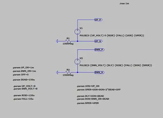

Well, Andy was right, I set "Maximum Timestep" to 100n and issue is gone.
However, after that, I realized that I can simplify even further PWM + deadtime generation like this (in case anyone needs). A million faster than my initial PWL approach.
  • UP_ON is for high side pulse
  • DWN_ON is for low side pulse
  • DEAD is after pulse
  • OFF is time after all together (so adjust overall duty)
