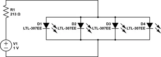

I'm stuck confirming that the current pulled in a circuit will be 15mA.
If I have hypothetical LEDs that pull 15mA each from 1.8V, and they are put in parallel (I know this is not a good idea, but just wondering what happened if is) with a 5V power input, the diagram should look something like this:
schematic
The LED's aren't actually 1.8v 15mA in the schematic, but lets just say that they are. Correct me if I am wrong: I supply 5V, the 213 Ω resistor drops the voltage by 3.2V.
This means that going into parallel, we have 1.8V, which is perfect for lighting negligible-resistance LEDs.
The LEDs at this voltage draw 15mA each.
Now here's where my understanding ends: I know that voltage is equal for every parallel branch, 1.8V, but does the current ADD together and the total pulled current will be 60 mA because of the 4 branches?
I tried to calculate the current of the circuit using Ohm's law. V = IR. 5 = I * 213, I = 23.5 mA. Is the pulled current actually 23.5mA, and the current is 'used' by the resistor? Or do I calculate the total current by subtracting the resistor? (I want to make sure I'm not pulling > 40mA for an Arduino)
I know I asked a lot of questions here and I apologize. Any help would be appreciated.

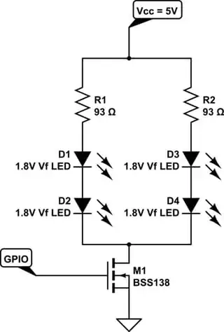

A better solution, given your 5V supply and Vf of 1.8V, would be to wire two pairs of series-connected LEDs and use a dropping resistor for each series pair. Then your total current is only 30 mA (15mA each pair.) Your dropping resistors would be (5 - 1.8 - 1.8) / 15mA = 93 ohms. Not only does this reduce draw on the driver, but it's twice as efficient.
Even then, 30mA is still kind of a lot for a GPIO. Instead, I’d recommend using a low-side FET to drive the LEDs. Also consider choosing a high-efficiency LED type that gives adequate brightness at a reduced current.
Here's what that all looks like:
schematic

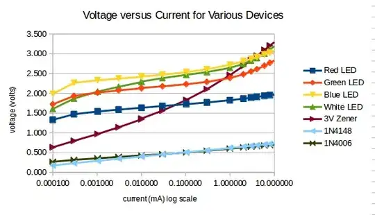

Here are some measurements I did of some diodes some long time ago.
You'll see that for the red LED (blue trace, sorry!) the current varies from 1 mA to 10 mA, a 10:1 range, while the voltage stays at about 1.8 V. Even at 10 uA, 1000 times less, the voltage on the LED is still up at 1.6 V. That's why we say that LEDs have a 'constant voltage' while the current through them varies. It's not really constant, just much much more constant than would be the case if it was a resistor.
Reading the data behind those graphs, 998 uA gives 1.825 V, and 10.01 mA gives 1.968 V. That's a change in voltage of 143 mV for a decade change in current. You can see the log/lin graph is more or less straight over that range, so we can express this relationship reasonably as voltage = k.log(current_ratio).
Now unfortunately, the LED voltage/current curve is NOT reproducible, as it varies with temperature, and varies from LED to LED slightly. Let's say that one red LED has 20 mV lower forward voltage drop than another, and you connect them in parallel. Using the LEDs of the graph, one would then take 40% more current than the other. This is why we tend to use a separate resistor to each LED. We can use LEDs in series strings safely, as they are all forced to be at the same current.
