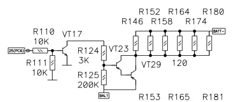

I've been reviewing this reverse engineered schematic of a bmax6 style lipo charger.
To my understanding this circuit is used to dissipate excess charge in a cell when balance charging. The circuit uses a parallel resistor network as the current sink (R146, R152, R158, R164, R174, R180). It appears that all 6 resistors are 120Ω, and thus the network has a total resistance of 20Ω (if I did the math right).
Balance Charging circuit showing a parallel resistor network
Why would circuit/pcb designer chose this configuration over a single 20Ω resistor? What are the pros and cons to consider when doing this?

Power dissipation will be the driver.
  • Using six in parallel allows use of standard resistors which may be a stock item.
  • Using standard parts allows use of automatic assembly equipment.
  • Lower profile.
  • Heat spread out over larger area resulting in lower peak temperatures.
  • Ability to combine to make a non standard value. The 20 Ω in your question is not an E12 value so it's probably not available in wire-wound.
  • Reliability: if one fails the circuit might continue to operate - but a cascade failure is likely.

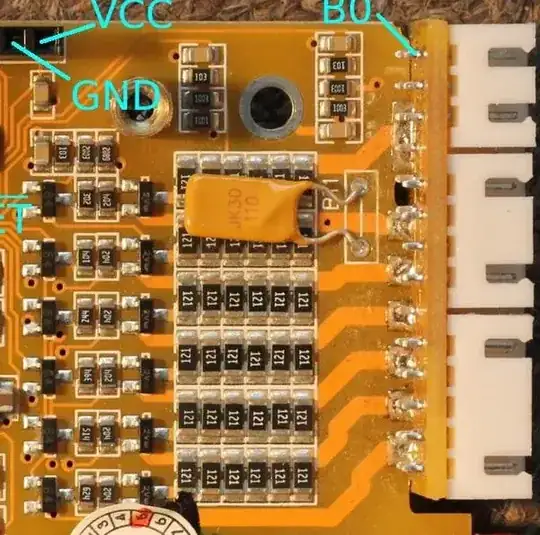

Let's have a look at the pcb...
It looks like they used several resistors for higher power dissipation. This is quite common, as several low power resistors may be cheaper than one high power resistor, especially if you already use the value somewhere else in the design, which means you already have them loaded on the pick and place machine so you don't have to load an extra reel just for the power resistors.
Also several small resistors can be spread over a larger area, so they make less of a hot spot and get more air cooling. If there are thermal vias to copper used as a heat sink on the other side of the board, spreading the resistors around will also spread the heat on this copper heat sink.
Notice the yellow JK30 thru-hole component sitting right above the resistors. It's a PTC resettable fuse. When the resistors heat it, its trip current threshold will get lower. Perhaps it is used as a temperature sensor to prevent the resistors from overheating... but it only senses the temperature of the top two rows of resistors.

An additional point that noone has yet mentioned: Redundancy
If one high power resistor fails, the circuit is probably affected significantly.
If one of your 120 ohm resistors fails (and nothing else does) then the 20 ohm effective resistance increases to 25 ohms, not an open circuit.
Of course the chance of a single component failing and not causing general upset, well that's low but not impossible.
