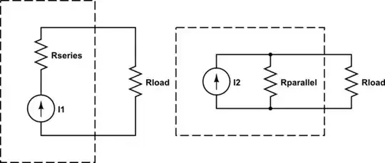

For the current source, \$R_{series}\$ cannot influence the output current. It cannot affect the current running through \$R_{load}\$. The ideal current source simply drives whatever current it wants to drive and it goes through both \$R_{series}\$ and \$R_{load}\$. Therefore, we do not talk about series resistances as an output resistance for current sources.
But it should be obvious that \$R_{parallel}\$ can disrupt the current that the ideal current source is trying to push through \$R_{load}\$, and the current that actually flows through \$R_{load}\$. Since the current source outputs a fixed amount of current, some current will be split between \$R_{series}\$ and \$R_{load}\$. That means that as more current is supplied, less and less current reaches \$R_{load}\$. So when we talk about an output resistance for a current source, we are talking about an internal parallel resistance.
Now...what do they mean when they say an IDEAL voltage source has zero output impedance and an IDEAL current source has infinite output impedance? Look at the circuits for V1 and I2.
What does \$R_{series}\$ have to make the circuit for V1 into an ideal voltage source? It needs \$R_{series} = 0 \Omega \$, ergo ideal voltage sources have zero output resistance.
What does \$R_{parallel}\$ have to make the circuit for I2 into an ideal current source? It needs \$R_{parallel} = \infty \Omega \$, ergo ideal voltage sources have zero output resistance.

So by now, you should have realized that the output resistance for a current source is considered to be in parallel, not in series like it would be for a voltage source. If this parallel resistance is infinite it doesn't block any output current from reach the load, rather it stops output current from leaking away before it reaches the load.

  • I'm actually talking about the opposite ("An ideal current source has infinite output impedance"), the idea that a current source has infinite resistance, which confuses me because I think of current as flowing, as infinite resistance blocks all flow. I don't think of voltage as something that flows, just a difference in energy levels / a "pressure" – user525966 Oct 04 '20 at 05:48
  • @user525966 Well, just look at the schematic for the non-ideal current source I2 which has an output impedance. For current sources, the output impedance is considered to be in parallel with the ideal source (as explained in the answer). Now, what Rparallel, have to be to make it become an ideal current source? It has to be infinite, right? Similarly, voltage source V1 needs Rseries to be equal to zero, right? Ergo, ideal current sources have infinite output resistance and ideal voltage sources have zero output resistance. – DKNguyen Oct 04 '20 at 05:52
