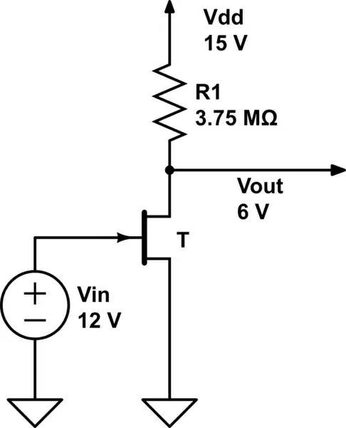

They achieve the construction of an inverter, with 15 V as Vdd, a 3.75 MΩ resistor, Vin = 12 V, Vout = 6 V.
schematic
It's not spectacular, but given the simplicity of the method, I wonder if such transistors could be used to make logic gates, an adder, and eventually a complete CPU (at least a design from the 70s with a few thousand transistors) entirely by hand or at least printed? Maybe on rolled-up or stacked-up sheets of paper?

If the gain of a single inverter is less than unity, then it will not be possible to combine any significant number of gates together to build a larger circuit. The signal levels will just peter out.
To be viable, a circuit for building logic needs to have output signals that are compatible with the input of the next gate. At first glance, your inverter has a 0-12 V input swing, but a 6-15 V output swing. The voltage gain is 0.75, and there's also a significant offset.

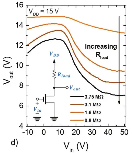

I found a copy of the paper here. In it, they provide the following graph of input vs. output voltage. It turns out that your notation of an output-low voltage of 6 V is overly optimistic — it only gets down to about 7V, achieved when VGS exceeds about 40 V! Even if you drove your first gate with the full 0 to 40 V swing, its output would only go from 13 down to 7 V. If you then try to drive a second gate with this signal, the output of that gate wouldn't budge at all!
Vin vs Vout
Furthermore, with the very high impedances involved, the clock speed would have to be extremely slow — probably on the order of a few Hz. Which would be fine for a demo, but not much else.
