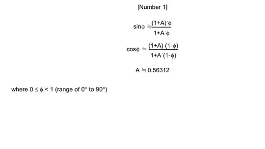

The figure illustrates appox sine function by the equation. How does this work? I could guess that quarter cycle of sine wave (0- pi/2) is approximated by the linear equation.

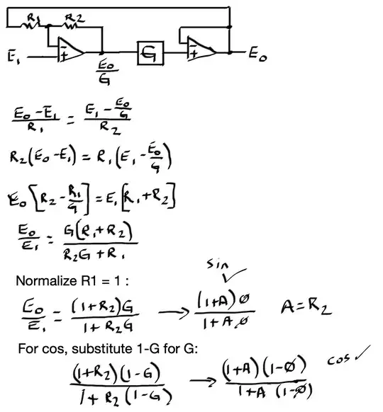

You are correct – the sine wave is approximated by the equation.
So there are two questions: does the circuit implement that equation, and how good of a sine approximation is it?
The answer to the first question is yes, the circuit does have this transfer function.
The R-2R ladder implements a D-A converter with a gain of 0 to 1, which is what you’re calling theta. Allow me to just call that a gain stage with gain G:
So to implement your A value of 0.56312, we’d pick R2 and R1 in a ratio of 0.56312/1, or something like R1 = 10K, R2 = 5.6K.

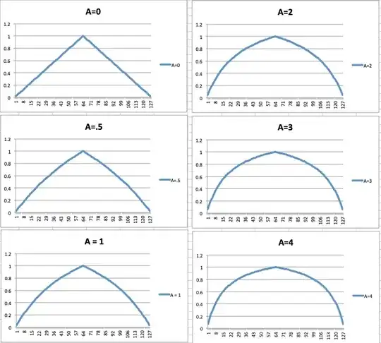

Now, how good of a sine wave can we do? Letting G go from 0 to 1 and back to 0 we see the top half of the resulting “sine”. Here is what the result is for various values of A:
It does appear that for a properly chosen A (around 3) the waveform does take on a reasonable facsimile of a sine. It doesn’t seem like 0.56312 is a particularly good value so I’m not sure where that came from.
If my math is correct then you’d want to make A about 3 (R2 = 3*R1) and figure out how to get the negative part of the sine, perhaps by inverting the input Ei, or allowing G to go negative. I’ll leave that as an exercise to the reader or other answerers.

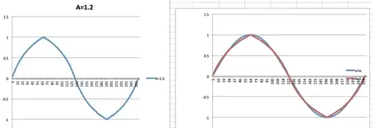

You can't get the symmetrical negative waveform by inverting Ei or allowing G to go negative: I don't know whose dumbass idea that was. Just run the theta up and down again and invert Eo this time.
My eyeballing estimate of A=3 being about the best was pretty far off: it turns out 1.2 has the least error vs. a true sine:
ANOTHER EDIT: @gari – to address your follow-up question as to how to extend to 4 quadrants.
The digital control (theta) only goes from 0 to 1, and that maps to the first quadrant. Ramping theta back down from 1 to 0 gets the second quadrant, no problem so far. For 2nd and 3rd quadrant we do the same thing (theta from 0 to 1 to 0) but invert the final output Eo. We could use “signed-magnitude” for our theta. Say it’s 8 bits: bits [6:0] go from 00-7f-00-7f-00 and sign bit 7 goes from 0-0-0-1-1. The sign bit would control a stage after Eo that inverts or passes it through.
