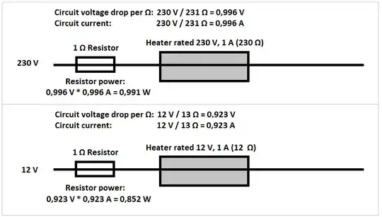

Lets think of fuse as small value resistor that burns with too much power.
If we move 1 Ω resistor from 12 V, 1 A circuit to be part of 230V, 1 A circuit the heating power of resistor will not change much. Low resistance of resistor and much higher resistance of high voltage circuit keeps the voltage and power of resistor close to the same.
In practice fuse is only affected by current.
Example of circuit
