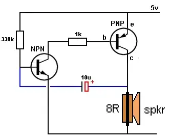

Recently, I found this circuit on the Talking Electronics web page:
Talking Electronics oscillator circuit
I was interested in the modified circuit below, where the feedback capacitor is replaced with short circuit and the 8R speaker with resistor of 8 ohms.

Without the feedback, the circuit is an amplifier, with current amplification of about 100 * 100 = 10 000 A/A. In the first scenario, when I add the short circuit while the circuit is running, the circuit continues working as before, but the voltage on the 8 ohm resistor has lower value. Maybe the addition of the short circuit removes some of the charge in the base of the NPN bjt, so it turns a little bit off, which in turn increases it's collector voltage, so the base current of the PNP bjt has lower value, affecting the collector current of the PNP and finally this decreases the voltage on the 8 ohm resistor. In the second scenario, both transistors are cutoff. Maybe this has something to do with the parasitic capacitance of the BJTs and their turn-on time.
I am kindly asking if someone can explain me how and why the circuit behaves this way.

    In the first case, you made a short circuit. So in real life, you will burn Q2 and Q1. Do you see why? In the second case, the voltage at the Q1 base is to low to open the Q1.330k and 8R for a voltage divider, or the speaker resistance is so low that all the current that is flowing via 330k will continue to flow through speaker resistance instead of a base. The speaker steals (takes) the entire current of the resistor 330k due to the low resistance of a speaker thus, now current is left for a Q1 base. – G36 Sep 18 '20 at 19:06
    Also, look here https://electronics.stackexchange.com/questions/338128/is-this-an-astable-multivibrator/338163#338163 and maybe this as well https://electronics.stackexchange.com/questions/261288/understand-2-transistors-npn-pnp-flasher-circuit-working/261407#261407 – G36 Sep 18 '20 at 19:07
  • @G36 Thank you very much for your answer. I think that NPN will burn because it's base current will increase enormously because of the short circuit, and its collector current will also increase, thus increasing the base current on the PNP, burning by the same cause. Also, I found the links you posted very helpful. – Bojan Sep 18 '20 at 19:57

  • @KevinWhite I am considering the circuit on the second photo, without the capacitor. The original circuit is only there to show where I got the inspiration for the question. By "the circuit is working as before", I mean before adding the short circuit and after adding the short circuit (or more precisely before and after closing the switch) – Bojan Sep 18 '20 at 20:40

It's not clear in the above schematics where the input is, or how it's coupled. The reason for the voltage changes, though, is that the capacitor doesn't interfere with the DC biasing of the circuit. The short, however, does, since it ties the DC level at the NPN base to the DC level at the output.
The biasing of this circuit seems to be dependent on the gain of the individual transistors, an unreliable system since there is a wide (or potentially infinite) range of variation across individual parts and across environmental conditions. Also, the feedback appears to be positive, since increasing the input (assuming it's coupled to the NPN base) increases the output, so it will increase the gain at the risk of instability.
With the short in the feedback path, it appears that a momentary B-E short on the NPN would turn it off permanently. Once the NPN stops conducting, so does the PNP, and the load pulls the NPN base to ground full time. You'd have to have an input signal capable of driving the load to overcome this.
