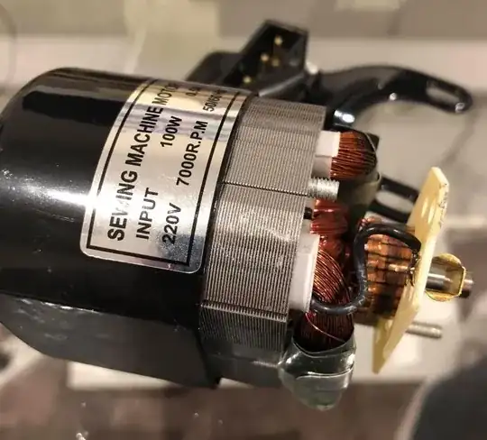

I have purchased a sewing machine motor from AliExpress. The issue is that it spins in the wrong direction. I opened it and only see 2 wires going to the brushes.

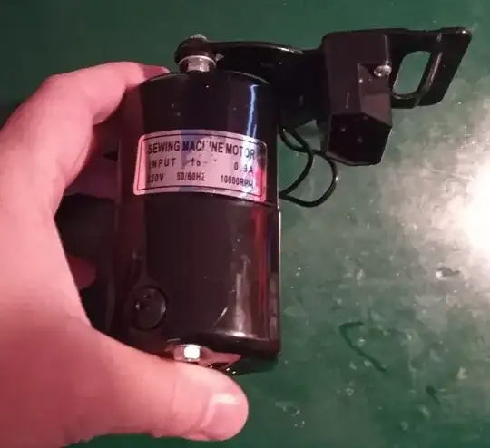

My motor is a near twin of the one in the question:
Mine says 10000 RPM instead of 7000 RPM, but that's about it.

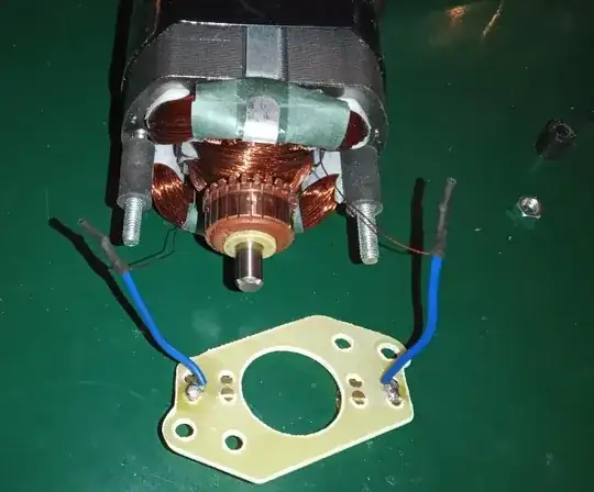

Once you get the rear housing off, you see that it has the same little PCB on standoffs holding the brushes:
Take the board off and pull gently:

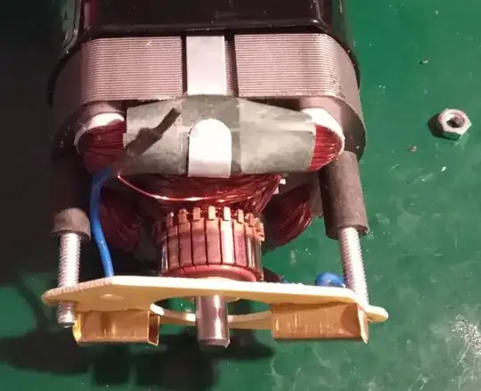

The wires are long enough, you just need to insulate the connectors:

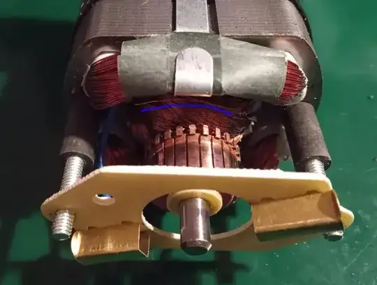

Rotate the board 180 degrees and put it back on the screws:
Tuck the wires back in so that they don't touch the commutator (the copper bars that move) or the rotor (the coils that move) so that they won't cause a short circuit:
Put the housing back on and reinstall the brushes. Your motor will now turn in the opposite direction.

  • @RussellMcMahon Thank you very much for your reply. I fully disassembled the motor and found that there are 2 wires in the whole assembly. They go directly from mains through the field windings to the brushes. I think that if I do as you said, and switch the brush wires it would be the equivalent of desoldering the board containing the brushes and rotating it 180- nothing will be changed. Im not an EE experet so please correct me if I am wrong. I have reassembled it because I decided I will 3D print a gear box, but if you think it is still possible I will disassemble and take pictures. – HazenAL Sep 19 '20 at 06:39
  • @HazenAL NO!!!! - hopefully :-) - Hopefully you have got it SLIGHTLY wrong. Enough so to help. I suggest that the path is eg Mains1-brush1-brush2-field_coil_Mains2. The key point is that mains is going into one brush and out the other - and in bewteen the two brushes it goes through the commutator, through the rotor coil , out through the commutator and then to the field coil . || If so (and it is 99%+ likely I am correct) ALL you have to do is swap the wires on the brushes (as per my answer). If you have eg mains to brush-A, field to brushB you change it to mains to BrushB, field to brushA. – Russell McMahon Sep 19 '20 at 06:54
