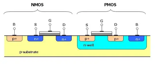

In a standard CMOS process, an simplified sideview of the NMOS and PMOS looks like this:
Source
The NMOS transistor "sits" in the P-substrate and has a p+ Bulk connection. Note how the Drain and Source area of the NMOS are N+. So there are P-N junctions between the P-substrate and these N+ Drain/Source areas. We do not want these diodes to become forward biased. So therefore the P-substrate has to be kept at a low voltage so we usually connect it to ground as that is usually the lowest voltage (actually 0 V). This is done through the NMOS's Bulk (P+) connection.
The same is true in a "reversed" way for the PMOS, the PMOS "sits" in an N-well. That N-well has to be at a high potential to keep all the diodes (N-well to Drain/Source but also N-well to P-substrate) in reverse mode. So we need to connect the N-well to the highest voltage which is usually the positive supply Vdd.
In such a standard CMOS process the P-substrate of the NMOS is shared across the whole chip so all NMOS transistors share the same P-substrate / body. That means that the body of the NMOS must be connected to ground.
The PMOS has it's own N-well and that N-well can also be made larger and shared between several PMOS. In some cases it can be beneficial to connect the N-well not to Vdd but to a lower voltage. This reduces the body effect which increases the threshold voltage. As long as the N-well to Drain/Source diodes remain working in reverse mode, not connecting the N-well to Vdd is OK.
Some processes are more complicated and have an option (called Triple-well) to create a P-well inside the N-well, that then allows us to make NMOS transistors in a sort of "isolated" N-well and then we can also do what we can do with the PMOS body and that is connecting it not to the lowest voltage but a somewhat higher voltage. Again that would reduce the Body effect which is helpful in some situations.
