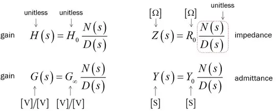

In the expression we have seen, \$H_0\$ has the dimension of a gain while \$\frac{N(s)}{D(s)}\$ is unitless. Therefore, the following format naturally comes in mind when dealing with different types of transfer functions:
The leading term carries the unit of the transfer function, if any.
