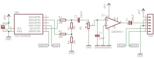

On the same power supply I have connected MAX7219, which is producing terrible noise to amplifier so I can hear refreshing frequencies of MAX7219. If I hook up amplifier to battery power supply the noise is gone. I've also tried to connect 220uF electrolytic capacitor to power supply input of this board, which decreased the noise but not removed completely. Shutting down MAX7219 for a moment, eliminates the noise. Still I can hear it even from far distance. Amplifier board is on small PCB. MAX7219 is on breadboard connected to Arduino. All powered from Arduino.
I understand breadboard wiring may produce some noises, but this one is too loud. Unfortunately I don't have the scope to tell the noise spectrum, but MAX7219 update frequency from datasheet is 800Hz.

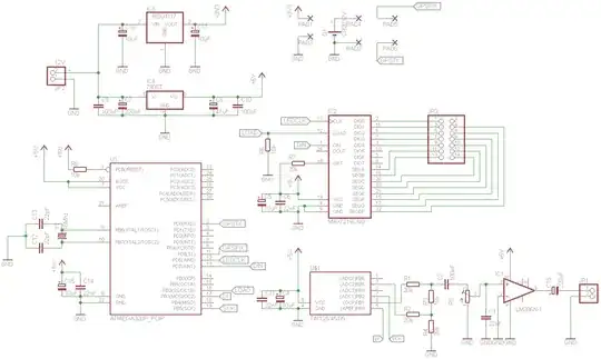

  • I don't see any MAX7219 in your schematic. – The Photon Dec 23 '12 at 01:58

  • From your video it sounds like inductor whine. Sounds like you need a bigger (higher) inductance value to lower the frequency of oscillation in the SMPS. I think, as @ThePhoton explained, critical detail is missing in your schematic. – DrFriedParts Dec 23 '12 at 02:40
  • @The Photon: I thought the key part of eliminating noise is the PCB with ATTiny and LM386, now I see that the problem is much more complicated and involving MAX7219. I've added 220uF to the power input lines on breadboard of PCB above, which decreased noise more than if I add that capacitor directly to supply pins of MAX7219. Will update my post with MAX diagram. Reading number of articles there is something about separating grounds for analog and digital. This is my first PCB. – Pablo Dec 23 '12 at 09:44

  • @The Photon: full schematics with MAX7219 in the update message. Thanks. – Pablo Dec 25 '12 at 19:34
    @Pablo, Spent a minute or two reviewing your schematic. Overall it looks very good. It's a long shot for solving your problem, but you might consider using more tightly spaced values for the bypassing capacitors instead of 10 uF || 22 nF. I'd suggest 10 uF || 1 uF instead. See Murata's app note (pages 18-19) for discussion of the "antiresonance" problem, which can happen when parallel capacitors are more than about 1 decade apart: http://murata.com/products/catalog/pdf/c39e.pdf – The Photon Dec 26 '12 at 17:15
  • Also, I'd add local bypassing from +5V to GND at IC1. The LM386 datasheet shows PSRR strongly dependent on bypassing. – The Photon Dec 26 '12 at 17:29
  • @The Photon: interesting app note, definitely worth to read. thanks for time! I'm going to try 10/1 as well. It's going to be long battle ) – Pablo Dec 26 '12 at 17:30
  • @The Photon: do you mean to add capacitor on power/gnd of IC1? – Pablo Dec 26 '12 at 17:32
  • @Pablo, yes. I was using the names you gave those nodes in your schematic. – The Photon Dec 26 '12 at 17:36
  • @The Photon: "typical applications" of LM386 stating 0.05uF ceramic capacitor connected to power line. I'll do the same. – Pablo Dec 26 '12 at 17:43
