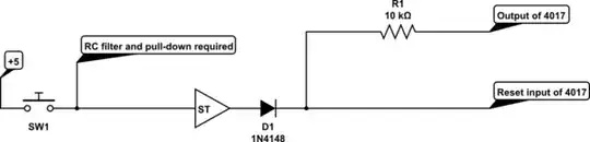

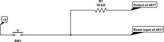

You can do this. You don't really need the ST gate on an asynchronous RESET input, and if you did, you'd need more parts to make it work properly.
schematic
Edit (retaining the gate):
schematic
simulate this circuit
Spehro Pefhany
  • 397,265
  • 22
  • 337
  • 893
  • I do need the st gate, for clarity I simplified the circuit but in reality it is important, what suggestions do have for keeping the st in the circuit? – Jay Sep 04 '20 at 15:36
  • Add a 1N4148 diode from the gate output to the reset input and retain the 10K resistor as above. – Spehro Pefhany Sep 04 '20 at 15:39
