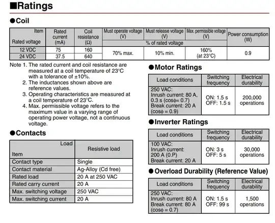

You should use a relay that has a motor rating, obviously a rating that is high enough to include the motor you intend to operate.
Here is a relay with such a rating.
If you use an underrated relay it's possible to have a failure that is not as benign as failing to close after a fair number of cycles. For example, the contacts may well weld closed. And maybe after 10 cycles or 20.
