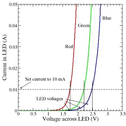

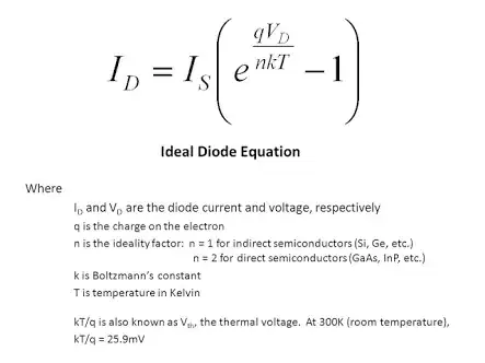

The 'forward voltage' given in an LED datasheet is a nominal value at a stated current (e.g., 20mA).
However, the LED current will vary widely with the applied voltage. Diodes (including LEDs) have an exponential voltage-to-current relationship, modeled in the Shockley Ideal Diode Equation as follows:
From this answer: Voltage across diode, Shockley equation
Notice the \$V_d\$ term in the exponent. That's your forward voltage. This means that as \$V_d\$ rises, you get a typical LED current-vs. voltage that is a very steep (exponential) curve with a 'knee' at the bottom, like this:
from this answer: Does LED brightness change with voltage?
In other words, little variations in \$V_d\$ result in big variations in \$I_d\$, and thus, brightness.
What this means to you trying to run a 3.3V LED from a Li-ion, is that your supply voltage is close to the LED forward voltage at your desired operating point. This makes your load resistor IR drop very small. Your setup will be exquisitely sensitive to variations in both the supply voltage and the LED's actual forward bias behavior, which itself varies with tolerances and temperature.
This link explains this resistor sensitivity in a graphical way: https://www.khanacademy.org/science/electrical-engineering/ee-semiconductor-devices/ee-diode/a/ee-diode-circuit-element
