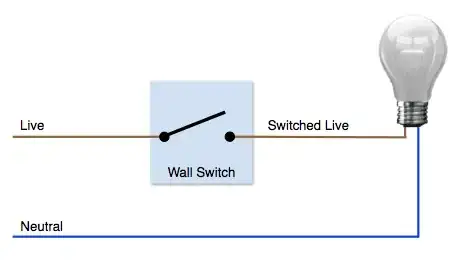

General appliance wiring looks like this:
switched live
This is "switched Live" and is the preferred way to do it because once you switch it off, the appliance is not connected to high voltage. It's safe for servicing without risk of a shock.

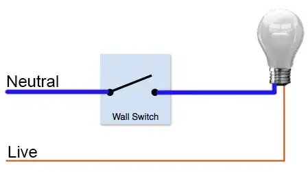

In case you put the switch on the neutral line instead of live, that case becomes "switched neutral" as shown below:
switched neutral
In this case, you need to be extra careful while servicing the appliance. Even if the switch is turned off, the appliance will get a high voltage and there is a risk of electrical shock. Make sure you turn the live MCB off before servicing to avoid a shock.

    This is not allowed by the electric code as far as I know. – user57037 Aug 25 '20 at 07:45
    @mkeith Yes, switching only the neutral is generally forbidden. Switching both phase and neutral together is generally allowed and in some countries mandated. – SomeoneSomewhereSupportsMonica Aug 25 '20 at 08:10
    This also does accidentally happen in cases of do-it-yourself wiring... My house is a prime example. – MadHatter Aug 25 '20 at 17:46
    A lot of Autos did this. But for mains wiring if Megger testing is anticipated you may have a switch on both lines for a de facto double pole isolation. Storage hot water, say. I have also seen (but will not name) IP Power Boards that switched neutral, presumably to keep active off the motherboard. – mckenzm Aug 26 '20 at 03:05
It's a switch in the neutral wire, instead of the hot/live/phase wire.
It is generally considered to be a bad thing, as turning the switch off turns off the appliance, but there is still a live feed to the appliance. This presents a shock risk to anybody replacing lamps or servicing an appliance.
