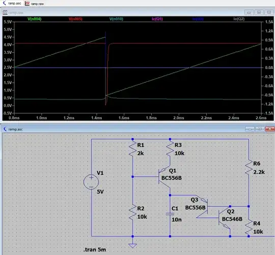

Here is a nice and straight-forward sawtooth oscillator that I learned from this video.
It is simple and nice. When we come to higher frequencies though, I am dealing with very finicky adjustments that end up breaking down. I can reduce R3 and C1 to get the slope up, but that only works until a few-fold increase, and then I'm at the end. The R1 can be tuned a little, but needs to be 1k for higher speeds. And at some point the difference between 1.5k and 1.8k makes the difference between life (oscillation) vs. death.

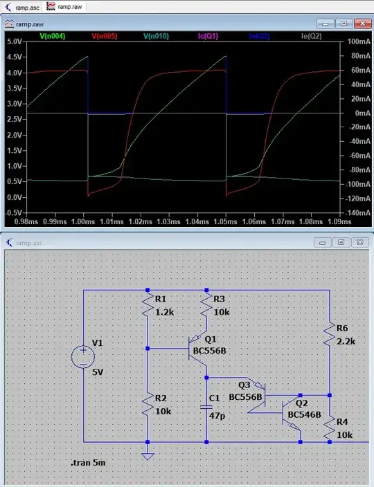

Like, even setting C1 to 1nF, with that R1 of 2k, nothing works. Reducing R1 to 1k gets the oscillations back. But we're not at much higher frequency, actually, we're at lower frequency.

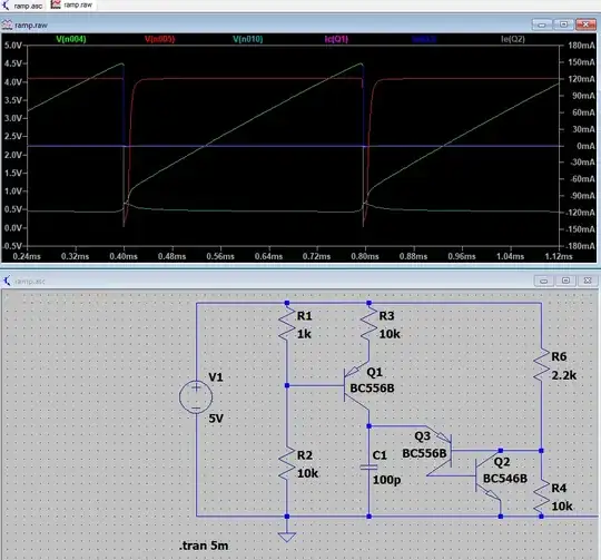

We can do C1 = 100pF and R1 = 1kOhm and get about 2.5kHz. But now we're beginning to have non-linear starts and ends of the sawtooth:
and from there it gets only worse:
is it the switching speed of the BJTs that's causing this non-linearitiy? I am surprised that it is happening at frequencies that are still pretty low. Here we are only at 20 kHz, i.e., even if I wanted to use this as an sawtooth for an audio use case (sound synthesizer) I am already stretched to get that right.

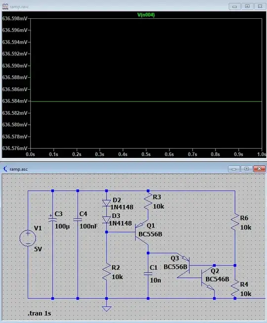

UPDATE: I took the suggestion of using the two diodes instead of R1, and unfortunately it's flat-lining and I can't find a proper C1, R2 and R3 that would make it oscillate.

  • @Andyaka, the flat line V(n00x) should be the output of the oscillator between C1 and collector of Q1.

  3. Replace R1 with 2 1N4148 diodes in series to lock the voltage of R3 at ~650 millivolts. Reduce R2 so bias current for diodes and Q1 is ample. R2 can be as low as 2.2 K without heating the diodes or Q1.

  • I followed your instructions, the pair of diodes needed to be done, but I couldn't find the right values to bring it back to oscillating. Updated in the OP. – Gunther Schadow Aug 25 '20 at 02:54
    It is possible that it needs instability to make it oscillate. The diodes would have stabilized the current, yet dynamics in the current help make it oscillate. I am siding with jonk in that you could use a better design. –  Aug 25 '20 at 03:15
  • I added a EDIT section with some observations. –  Aug 25 '20 at 03:26
  • I find your observation that instability is needed quite deep and important, and possibly a drawback of all simulators, as they might not add any noise which would trigger an oscillation. In this case is seems to obvious that the circuit should oscillate, and it does if I use a timed source to trigger the discharge. But somehow if I use this SCR thingy or even my Darlington configuration and a simple BJT based comparator, the simulator enters into some weird steady state, in-between, and probably in real life it would oscillate fine. – Gunther Schadow Aug 25 '20 at 16:37

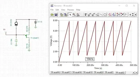

16kHz oscillator with 2 semiconductors: ujt
csabahu
  • 2,226
  • I like your simplistic answer, so +1. However if you Google "Sawtooth generator schematic" you will find thousands of examples. Remember the OP may want an easy-to-adjust frequency. –  Aug 26 '20 at 00:25
  • I love it. What is that D1 E102 component? A constant current diode of 0.8 - 1.1 mA. So that means we could adjust the frequency by using a variable capacitor or by adjusting the charge level / amplitude. and you use the J-FET to reset. Very interesting. – Gunther Schadow Aug 26 '20 at 02:27
  • Yes, the frequency can be adjusted with the capacitor or to a lesser extent with the voltage of UJT B2. Alternatively, the diode can be replaced with a low current JFET and then the current can be controlled by the resistor SG of the JFET. – csabahu Aug 26 '20 at 07:38
