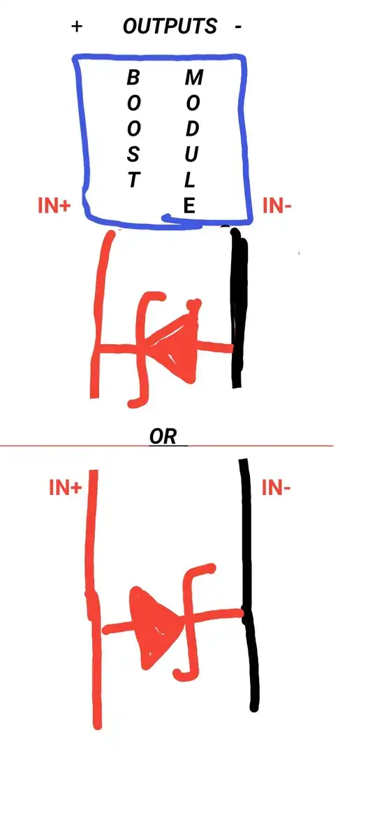

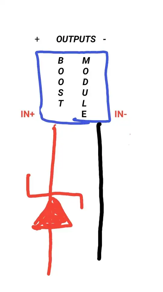

In short it recommends to place a diode (out of interest I've bought a schotkky 10SQ050) in series at the input port to protect against reverse polarity, but what I don't understand is; do I simply just place the diode (with Cathode connected directly to the in+) inline of the In+ line? see figure 1. OR must it be placed in parallel with the in+ and in-? If so then in which direction would the diode be placed? see figure 2
I would really like to understand more. It doesn't make sense to me that the diode is to be placed in series with the input, despite it stating it needs to be in series, so I just want to understand. Please help me understand! Thanks a ton for your time!
Figure 1:figure 1
Figure 2:
Figure 2

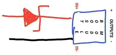

The web page says this: -
Please Series diode at the input port
And that makes sense so use this: -

  • Series blocking reverse prevents damage but reduces input by diode drop at high current.
  • Some Schottky diodes at high current drop more than Silicon if under-rated. But this is 0.7V @ 10A so ok.
The preferred way now is to use the ideal diode dual FET blocking IC’s, but only necessary for low voltage battery chargers.

"In series" means in series, therefore option 1.
Option 2 and 3 are "in parallel".

  • Thanks Marcus. I do understand series and parallel i just wanted to understand why in series? – Audiosine Aug 23 '20 at 12:08
  • well, you seem to know what a diode does. So, mentally try out what the other two options do when you connect the supply correctly and reversed. Not quite sure what the remaining question would then be? – Marcus Müller Aug 23 '20 at 14:41
  • Thanks Marcus. I take a quote from a previous comment: "I will place in series as stated. But could you perhaps explain why it is placed in series? Or more so what is the point of the diode? I know for reverse voltage..." I think what I'm getting at is the fact that i don't understand how, by placing the diode on the input of the boost, it works." – Audiosine Aug 23 '20 at 15:24
  • Understanding that the diode only allows the current to flow toward the boost. So if i flip the polarity meaning my + voltage is now flowing into the -VIn meaning that the boost is being given voltage in the negative side of the boost, does this mean current tries to flow out of the +Vin? But cannot due to the diode? Not sure. Apologies in my abstract questions. I'm trying to grasp HOW the diode prevents this reverse polarity. – Audiosine Aug 23 '20 at 15:25
