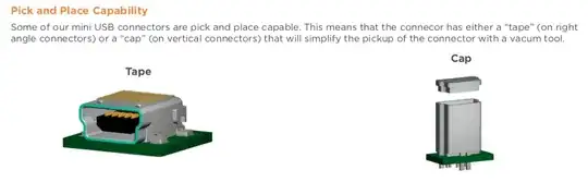

The official name is Pick and Place Pad. While this can refer to hard parts added to bigger or irregular shaped parts for pick and place, it also refers to the tape used for picking.
The tape a high heat, non-conductive tape, used for pick and place machine tips to suck onto to place the connector on a board. It may be Kapton, a name brand Polyimide tape, or may be an alternative brand and type tape. Others use Mylar for example. It just needs to survive movement and typical wave soldering or other automated SMD soldering solutions.
From a manufacturer data sheet: https://www.te.com/commerce/DocumentDelivery/DDEController?Action=srchrtrv&DocNm=1-1773973-2_Mini_USB_Connectors&DocType=DS&DocLang=EN

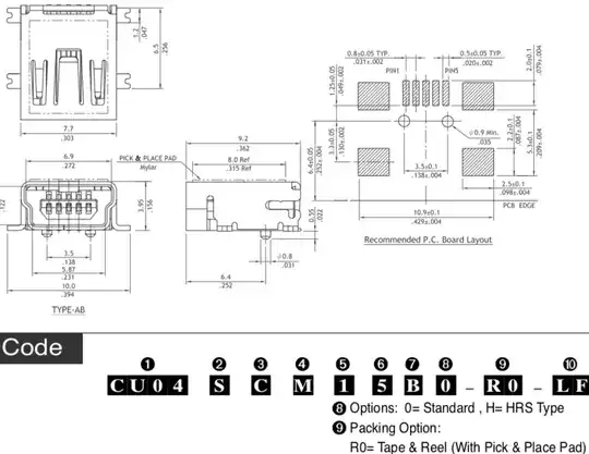

For another one, Mylar tape specifically.
http://www.assmann-wsw.com/fileadmin/datasheets/ASS_1456D_CO.pdf
And another: http://www.elstore.it/wp-content/uploads/prodattach/CU04SCM15B0-R0-LF.pdf
