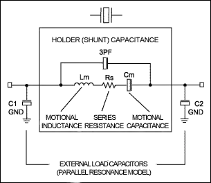

I read that in a quartz crystal:
For a series-resonant crystal, the crystal current is the RMS voltage across the crystal divided by the crystal internal series resistance. Meanwhile, for a parallel-resonant oscillator, the crystal current equals the RMS voltage across the load capacitor divided by the load capacitor's reactance at the oscillator frequency.
The model given on the site is: enter image description here
The bold context confuses me. It's like saying that the impedance of the whole LC tank circuit at parallel resonance is equal to the reactance of the load capacitance Why is that?
What I only know is that impedance is max at parallel resonance but I don't know why the max impedance in this configuration is equal to the load cap
source:https://www.maximintegrated.com/en/design/technical-documents/tutorials/7/726.html

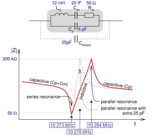

Firstly, series resonance and parallel resonance are very similar in frequency but they are different. So, at series resonance the impedances of Lm and Cm precisely cancel leaving Rs (or Rm as shown below) as the dominant impedance. Rs happens to be in parallel with the shunt capacitance (Cp) but, Rs dominates as it is quite low (circa 100 ohms).
In parallel resonance (a slightly higher frequency) the series inductive reactance is slightly higher than the series capacitive reactance and this means that the resulting net inductive reactance becomes parallel resonant with the parallel capacitance (Cp).
Here's a better view of things: -
I've put some numbers on things to show typical values for a 10 MHz crystal. The above picture taken from my answer here.
It isn't and you are right to be confused. There is a lot of BS written about crystals from some sources that should know a lot better.
