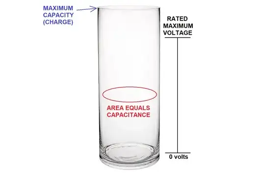

Consider a glass of water: -
I vaguely remember that 100μF represent the capacity of a capacitor
No, capacity is how much something can be filled without spilling. Capacitance is the term measured in farads and is equivalent to the area of the glass above.
The height in which water is filled is equivalent to the voltage and therefore capacity is capacitance multiplied by voltage. This equals charge i.e. Q = CV.
So my question is, do 10V 100μF and 16V 100μF capacitors have the same capacity
No they have the same capacitance. Capacity is how full you can safely fill the capacitor and that related to charge (Q = CV).

  • Thank you! When the capacitors are set to release energy, would they release the same amount of energy (meaning the same voltage and the same amperage)? – Aero Wang Aug 16 '20 at 10:22
  • The energy stored is $\dfrac{CV^2}{2}$ so if both have the same capacitance and are at the same voltage then yes. – Andy aka Aug 16 '20 at 10:28
    I never was aware of this difference. Is this some official definition, that the capacity is given by capacitance and voltage rating? I can completly follow the logic, but I never heard somebody use the term capacity like that before (in regard to a capacitor). – jusaca Aug 16 '20 at 12:14
    @jusaca it hardly ever gets called capacity (maximum charge that can be held aka C.V) but, the OP called capacitance "capacity" and I used the water glass to point out the difference between the terms. – Andy aka Aug 16 '20 at 12:22
    I see. In german both terms translate to the same word, so I probably never made a difference. – jusaca Aug 16 '20 at 12:38
    I'm probably using the term capacity more like how we use it for a battery. You could argue that $I\cdot dt = C\cdot dv$, hence "ampere seconds" is like battery capacity and it equates to capacitance x voltage change. – Andy aka Aug 16 '20 at 12:46
  • Yes, It definitely makes sense. – jusaca Aug 16 '20 at 12:52
  • You can continue the analogy by calling it a pressurised water tank instead of a glass jar. If you have a higher pressure (voltage) then you can store more water (charge) in the same volume (capacitance). But if you exceed the pressure (voltage) the tank can handle then things go bang. – Graham Aug 16 '20 at 19:57
  • @Graham, I've always been told that water doesn't really compress under pressure, so a tank of gas might be a better example. – ilkkachu Aug 16 '20 at 22:32
  • @ilkkachu Everything does compress, but liquids need more force to get them to squash up. :) Gas is more squeezable, so you're right, it might improve the analogy. – Graham Aug 17 '20 at 00:04
  • The analogy works better with a water tank. The voltage corresponds to the pressure at the bottom of the tank. The charge corresponds to the volume of water in the tank. Current flow corresponds to volumetric water flow. Once it is too full, it overflows or blows up or whatever. The voltage rating is the pressure at the bottom of the tank once the tank is full. – user57037 Aug 17 '20 at 06:02
