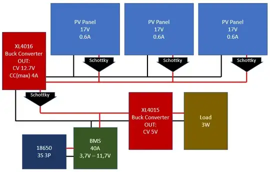

Can I charge Li-Ion safely by connecting PV Panels to a CC CV Buck Converter then through BMS to a 3S3P batteries?
This is basically a plan for a very small solar powered device that takes in solar power (30 Wp), simultaneously charging batteries and powering the device for a few hours during the day (as long as buck's output voltage > battery voltage) and use the battery when the sun is out (battery voltage > buck's output voltage). The device/load (3W) is to be powered continuously.
Please let me know of any of your concerns, especially in regard to hazards and references.

  • Data sheet links to the modules are required. Links to pee-bay (et al) means that you are considering buying from a source that is not well documented or reliable. Think again is my advice. – Andy aka Aug 11 '20 at 10:13

    Main issue (I think) is that a BMS is NOT designed to be a charger. It prevents gross excess conditions and may do balancing BUT is not designed to do proper CCCV charhing and charge termination. (SOME BMSs may have proper charging functions as well but its rare). || A "proper" charger will do CC charge to usually 12.67V, then CV charge to say Imax/4 say THEN fully remove charge voltage. A BMS will usually leave Vmax on battery indefinitely. Battery WILL die. – Russell McMahon Aug 19 '20 at 07:58
  • thank you, so, for the least, i should've to put a 12,6V triggered relay between the charging buck converter and BMS so the charge will be terminated completely. This may not charge to 100% due to termination will occur and will not proceed to CV phase, but it will prolong battery life, am i correct? – yuda Aug 22 '20 at 09:44
It's probably safe because it won't likely work as the Buck charger will probably collapse the PV voltage to very inefficient low voltages.
A MPPT controller will hunt for the MPT by matching load impedance to the PV source for any solar condition. Max Sun each PV is Zmpt=Voc/Isc=17V/0.6A.
Also, this block diagram is rather simple and leaves a lot of specs out.
Tony Stewart EE75
  • 54
  • 185
  • Thank you! so will it not work or will it work but inefficiently? What other information would you need me to put in it? – yuda Aug 11 '20 at 11:27
  • won't likely work unless it has a soft start with MPT regulation. CC mode from a PV? impossible without impedance matching and a current source is high impedance. – Tony Stewart EE75 Aug 11 '20 at 11:31
  • What does soft start do? In this case, I'm using CC to cap current flows, even without CC the max current the PV can possibly put is 17/12.7*0.6A= 0.8A x3= 2.4A, assuming 100% efficiency, I guess that wouldn't hurt the 3P battery. Is impedance matching mandatory for charging or will it increase efficiency? – yuda Aug 11 '20 at 11:57
  • @yuda There are two requirements: MPT (maximum power transfer) regulation and soft start. The MPT regulation is a primary requirement, once you got that taken care of, soft start should be easy. In a nutshell: buck converter is OK but it won't work by itself: it needs to be in an MPT control loop. You also seem to think like getting better efficiency is just a bonus. Not at all: in this application it's critical, since a buck converter by itself will tend to run the panels at 1-5% efficiency. And since panels are expensive, getting maximum power transfer is essential, else you're wasting $$$ – Kuba hasn't forgotten Monica Jan 25 '21 at 14:59
  • I mentioned Match Impedance, and when done from the startup means "soft start" is guaranteed but only if sufficient power to regulate V. I didn't show how, just that – Tony Stewart EE75 Jan 25 '21 at 15:09
  • Hi, so I made the device in Aug'20 and it's been running well since. It went off several times due to rain in Dec'20 and Jan'21 (wet season here nov-apr) and I took the opportunities to check the batteries voltage. All 3.66V, so I think they're fine.
    And I found this pub https://www.researchgate.net/figure/Comparison-of-output-power-with-and-without-MPPT_tbl2_273594839 . the wattage is similar to what I have, and using MPPT shows an increase in efficiency (<10%) but doesn't it imply that I can do away without?
