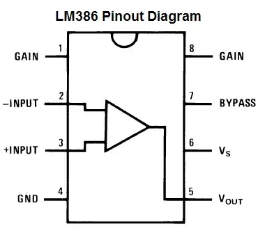

I am not an electrical engineer, but I am curious enough and my mind tells me to make a radio circuit.
Now I am into it, so to make one, I need some components, but before that so that I can be a little more into basics of the working of the device, the only device I can't find an explanation for is the LM386 IC.
It is an audio amplifier but its pin-out is not that clear. It shows a simple triangle but no information.
What is it? A logic gate, another IC?
Please explain to me how the LM386 works.

The LM386 is an IC. The triangle is just a symbol use on a schematic diagram to represent the IC.
If you consult the manufacturer's datasheet for the LM386, you should find a full description and schematic of the internal circuit, and also a description of the physical package of the part, with the dimensions and pin locations.

The LM386 is an audio power amplifier. "Power" in this case usually is less than 1 watt. In a sense it is a specialized version of an operational amplifier, so it usually is shown on a schematic with an opamp-like symbol.
Here is the datasheet from the company that invented it: https://www.ti.com/lit/ds/symlink/lm386.pdf
Only one of the schematics in the datasheet shows a decoupling capacitor across the power pins, but it is critically important that it be there for any/all circuits. The capacitor(s) should be as close as possible to pins 4 and 6, with the shortest possible leads. I recommend a 0.1 uF ceramic and 10 uF electrolytic in parallel. All audio power amp chips are very sensitive about this.

Here is a pinout diagram of the lm386. And I believe this is its most general format.
lm386 pinout
