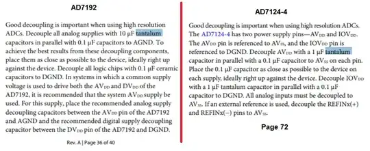

It's pretty much legacy information. For instance, the AD7192 on page 36 says the same thing and that dates back to 2009. The AD7124 is 2015 vintage and it appears to have just copied over some of the same words: -
If I could be bothered to go back further I'm sure I'd find that pretty much all similar devices that are older say the same thing.
