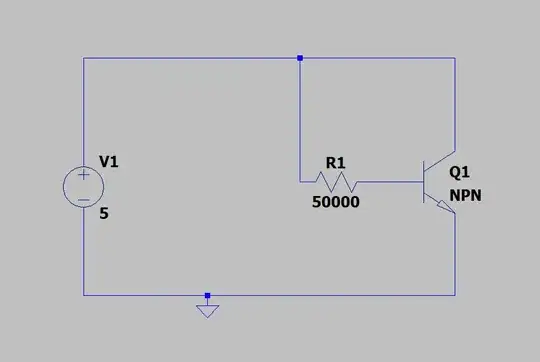

I'm trying to solve the following circuit, obtaining all the currents and voltages.
I'm using mesh analysis method, but I'm ending with wrong results.
So I assumed by default a clock-wise loop for \$I_b\$ and the same for \$I_c\$.
The \$\beta=100\$
I setted the equations to obtain base current \$I_b\$:
$$5-50000(I_b-I_c)-0.7 = 0$$
and deriving from the \$beta\$ the collector current \$I_c=100 I_b\$ I obtained with substitutions:
$$4.3 - 50000I_b + 50000(100I_b) = 0 $$
that gives me:
$$I_b=0.87\mu A$$
this result is too small and different from the results obtained from the simulation with the software every circuit.
This problem should be very easy to solve. How can I set the equations correctly to solve this kind of problem?
Thank You.
Carlo

    The current through R1 is just $I_b$, not $I_b-I_c$. – The Photon Aug 02 '20 at 23:50
  • @ThePhoton when i used the mesh analysis, the current of the other loop (in this case the one with collector current $I_c$) must be subtracted from the current of the first loop (base current). Anyway if I delete the collector current from the equation i will obtain 86uA as a result. But the simulation gives a current of 84.4uA. How can I get that result? – Carlo Aug 02 '20 at 23:58
  • @Carlo 84.4uA and 8.6uA are close enough for this hand calculation. – KarlKarlsom Aug 03 '20 at 00:00
  • @Carlo have you seen my answer? – Helena Wells Aug 03 '20 at 00:02
    @Carlo if you really want to be precise, you need to get the datasheet of the transistor and check the base current vs. Voltage diagram. The difference between your calculation and simulation should be that the voltage drop is not precisely 0.7 asset this current. – KarlKarlsom Aug 03 '20 at 00:02
  • @KarlKarlsom I usually use 0.65 V for every forward voltage of a diode. – Helena Wells Aug 03 '20 at 00:03
  • @Carlo you don't need to put ground. Voltage difference is what we measure not voltage of each pole of the battery. – Helena Wells Aug 03 '20 at 00:06
  • @KarlKarlsom yes you're right I don't know why this software consider a drop of voltage of $0.782V$ (since I didn't specify anything the default should be 0.7). So if I do this calculations I will obtain 84.4uA. Helena i know I don't need gnd but in softwares it is required to put the ground in the circuit to perform the simulation (at least in the one that I used). – Carlo Aug 03 '20 at 00:11
  • @Carlo Have you seen my answer? – Helena Wells Aug 03 '20 at 00:11

The schematic you show here is from LTspice, I believe. It's default NPN BJT has \$\beta=100\$ and \$I_\text{SAT}=100\:\text{aA}\$. Your "EveryCircuit" link is very unlikely to use the same default model. So LTspice probably will simulate different values. Just FYI.
Nodal Analysis
The nodal method is probably the easiest for solving this problem:
$$\begin{align*} \frac{V_\text{B}}{R_1}+I_\text{B}&=\frac{V_\text{CC}=5\:\text{V}}{R_1}\\\\ \frac{V_\text{B}}{R_1}+\frac{I_\text{SAT}}{\beta}\cdot\left(\exp\left[\frac{V_\text{B}}{V_T}\right]-1\right)&=\frac{V_\text{CC}}{R_1}\\\\ V_\text{B}+\frac{R_1\cdot I_\text{SAT}}{\beta}\cdot\left(\exp\left[\frac{V_\text{B}}{V_T}\right]-1\right)&=V_\text{CC}\\\\\text{conveniently set: }\quad V_{R_1\:\text{SAT}}&=\frac{R_1\cdot I_\text{SAT}}{\beta}\\\\V_\text{B}+V_{R_1\:\text{SAT}}\cdot\left(\exp\left[\frac{V_\text{B}}{V_T}\right]-1\right)&=V_\text{CC} \end{align*}$$
That solves out readily (see Appendix below for details) as:
$$V_\text{B}=V_\text{CC}+V_{R_1\:\text{SAT}}-V_t\cdot\operatorname{LambertW}\left(\frac{V_{R_1\:\text{SAT}}}{V_T}\cdot\exp\left[\frac{V_\text{CC}+V_{R_1\:\text{SAT}}}{V_T}\right]\right)$$
Spice Comparison
From which, using LTspice parameters and only the simplified portion of the model besides, I get \$V_\text{B}=833.4\:\text{mV}\$ using the above formula. Running LTspice on this I get \$V_\text{B}=829.1\:\text{mV}\$ which I consider quite close since I'm using a highly simplified subset of the model that Spice programs use.
Short Summary
So that's how you solve these kinds of problems with mathematics. (Use Wolfram Alpha to solve the first equation, if you need to. It's not hard to do on paper, though.)
With that base voltage worked out, everything else just falls out readily.
In the case of your "EveryCircuit" simulator, you'd need to find out the model parameter values it uses to get close to its simulation values. That's a different problem. But I'm sure it uses similar techniques to other Spice programs.

Current flowing through base will be 5-0.7/50000 = 0.000086A
Current flowing through the collector will IbxG = 0.000086x100=0.0086A
Voltage drop on the transistor (Vcollector - Vemitter) = 5V.
Voltage drop on the resistor will be 4.3V.
Anything else is wrong.If you simulator gives different results then it is wrong.First trust humans then machines.
