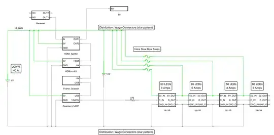

I'm building a TV Ambilight using a Raspberry Pi and 2812B LED strip. First draft schematic below.
Few questions:
- I intend to keep the strip connected and bend them around the TV and solder power injection into all four sides. Should I cut the 5V trace (highlighted in yellow on the schematic zoom) where I'm adding power injection or leave them connected? What's the impact of this choice?
- Is it safe to daisy chain a few 5 lead Wago connectors for the power distribution?
- Similar to #2, is it safe to connect the resistor, capacitor, and inline fuses via Wago connectors?
- I'm planning on using 4 amp slow blow fuses on the 3 amp sections and 6 amp slow blow fuses on the 5 amp sections - is this appropriately sized?
- Is 18 AWG sufficient? I calculated the voltage drop and it's on the order of a few percent for the length of wire I'm running. I've read these LEDs exhibit the same brightness from ~4.2-5V
- Any concerns with powering the Pi, HDMI-to-AV, and HDMI Splitter from the same power source as the LEDs?
- Is the capacitor sizing and location sufficient/correct, or would you recommend adding a capacitor at each injection point?
Thank you!

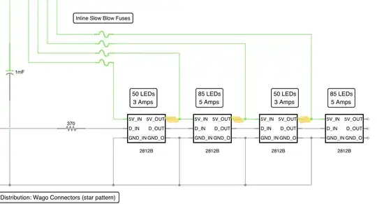

Schematic Zoom on LEDs:
As for the strips, they're sold by various Chinese suppliers on Amazon - I've yet to see a data sheet for one. I would love the opportunity to purchase 2812b LED strips with a data sheet, but this is what I've got.
