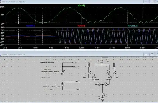

enter image description hereI am working on a difference amplifier example lab 5L.1 from Art Of Electronics Hands on Lab Course (I am not a student). I simulated three types of "tail" circuits using SPICE. Then I built the three types of "tail" circuits using MMPQ3904 array for the Q1 and Q2 pair and discretes 2N3904 for the mirror and sink circuits. I see basically the same clean output in physical circuits for ALL 3 scenarios (no common mode noise on the output). However, in SPICE, as I assume is more correct, I see the "long tail" circuit with common mode signal on top of the output. The sink and mirror are clean in SPICE. I thought the physical implementation of the "long tail" would show at least some noise as well. Is that a correct assumption?

  • Reading your writing, it appears that you are confusing the idea of noise with the idea of common mode rejection and interpreting your LTspice results on the basis of that confusion. Worse, you haven't even prepared a proper circuit for illustrating common mode rejection (or noise analysis.) So that's also a problem. So (1) you need to prepare better schematics for analysis; and (2) you need some help understanding the long tailed pair, better; and (3) you probably need some thoughts about what you are actually building and testing, too. Can you pick just one thing you'd like explained first? – jonk Aug 01 '20 at 20:19
  • Sorry all, for using wrong terms. I meant the output vo2 distortion due to CM input given by V5 source. CM signal is V5 = 1KHz, 1V. with 10 mSec delay; diff. signal is V6 = 100Hz, 0.2V created with center -tapped transformer in the built ckt. In SPICE v02 looks clean for 10mSec before V5 was added. After 10mSec there is 1KHz riding on the top of the amplified 100Hz output. Is that correct? I was expecting to see the same in my built circuit, since the "long tail" CMMR is worse then that of the sink and mirror. – vgeng Aug 01 '20 at 22:21

  • well, they show 27ohm for the setup with floating generator for diff. signals. So, i think, i have it correct in SPICE. Now, in the built ckt, my transformer has 2 secondaries, in which i grounded one side of each. And then ran CM signal via 27ohm. Maybe that was wrong. Did not look at Early effect, but i did question why one collector was not connected to the supply via a resistor. So, is SPICE output correct with that setup? I just received a true center tapped xformer and will try that w/o 27 ohm resistors. – vgeng Aug 01 '20 at 22:48
  • Thanks, I'll try modifying the ckt. I did use the current mirror and sink ckts, but my goal was to see how "bad" just using the R3 is and how it matches SPICE. – vgeng Aug 01 '20 at 22:52

  • Ok, so let's assume "long tail" ckt. CM input signal at 1KHz @ 1V. My diff. gain signal is 100 HZ @ .2V. CM gain is about 0.5. Diff Gain is about 40. So, in theory i should expect to see sum of output of 40.2V = 8V @ 100Hz and CM signal of 0.51V= 0.5V@1KHz. That is, I expect to see 8V sine wave at 100HZ with 1KHz riding on top of it. Is that correct? – vgeng Aug 02 '20 at 03:38

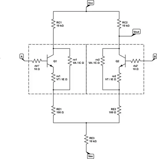

Starting Point
Here's the basic idea, with some added parasitics worth a moment's thought:
schematic
Above, I added the other collector resistor. The reason I did is because of \$r_{o_{_1}}\$ (Early Effect parasitic.) Without the added voltage drop across \$R_{C_{_1}}\$ there's a larger voltage drop across \$r_{o_{_1}}\$ and this leads to an unexpected increase in \$Q_1\$'s collector current that isn't matched in \$Q_2\$ under the same circumstances. I'm not saying you cannot operate the circuit well (reasonably so) without \$R_{C_{_1}}\$. It will work fine without it. It's just that if you are nitpicking tiny details, the differences will get in your way and confound your analysis. It's better if you simply remove that effect at the outset so that you won't waste time digging through some mysterious rabbit data-hole.
I've also added parasitics \$r_{e_{_1}}\$ and \$r_{e_{_2}}\$. These are actually pretty important for the purposes of quantifying the expected voltage gain (and to a smaller degree for your purposes, understanding temperature stability.) I'll talk more about this voltage gain issue, shortly.
Finally, I added the relatively unimportant (mostly) base bulk impedances \$r_{b\,'_{_1}}\$ and \$r_{b\,'_{_2}}\$. So long as the base current isn't too significant (and it won't be so long as you keep the voltage difference between A and B below a few tens of millivolts) the drop across these won't amount to much. But you may need to be aware of them, at times. So I added them. The values for small signal BJTs will be about the value I show -- perhaps to twice that much.
(I didn't add the bulk Ohmic collector and emitter resistances. Even in small signal BJTs they are usually under a few tenths of an Ohm.)
Response of VOUT to CM Changes
Let's assume away all the parasitics and just focus on the most important detail. This is the fact that if you lift both A and B by the same voltage (we are assuming an ideal voltage source directly applied to both bases) then the voltage across \$R_{E_{_3}}\$ increases by exactly the same amount (okay, slightly less for a variety of reasons, but one of them being that an increased collector current implies a larger voltage difference between the base and emitter of a BJT.) This means that the shared sink current increases and, assuming it divides equally to each BJT, causes of change of half that current variation in \$R_{C_{_2}}\$. That's most certainly going to cause the voltage at B to decline. So, right away, we know there's a problem using a resistor as a current sink.
How much? Well, assuming \$V_A=V_B\$, then \$\Delta I_{R_{E_{_3}}}=\frac{\Delta V_\text{CM}}{R_3}\$ and therefore \$\Delta I_{R_{C_{_2}}}=\frac12 \frac{\Delta V_\text{CM}}{R_3}\$ so then \$\Delta V_{\text{OUT}_\text{CM}}=-\frac12 \Delta V_\text{CM}\cdot \frac{R_{C_{_2}}}{R_{E_{_3}}}\$. With both resistors the same, as in your circuit, this works out to half of the common mode change. So if you change it by one volt, I'd expect a change at the output of half a volt in the opposite direction of the common mode change.
Now this would not be such a problem if you replaced \$R_{E_{_3}}\$ with something that acted a lot more like a current sink.
This doesn't mean you cannot use a resistor. It only means that if you do use a resistor, you need to be able to calculate some kind of estimate about the effect of common mode changes upon your output so that when you analyze the output you do see, with respect to changes you make in the common mode voltage, you at least will better understand the observations.

Assuming \$R_{E_{_1}}=R_{E_{_2}}\$ and that your signal's voltage amplitude is small (say, \$\le 1\:\text{mV}_\text{PP}\$) and the signal source impedance is negligibly low:
  1. You should expect to see a voltage gain at the output that is \$A_v=\frac12 \frac{R_{C_{_2}}}{R_{E_{_2}}}=50\$
  2. #1 will be wrong because it neglected \$r_{e_{_2}}\$, so we now compute \$r_{e_{_2}}=\frac{V_T}{I_{E_{_2}}}\approx 37\:\Omega\$ and then re-estimate \$A_v=\frac12 \frac{R_{C_{_2}}}{R_{E_{_2}}+r_{e_{_2}}}\approx 36\$
  3. #2 will be wrong because it neglected the varying gain and current in \$R_{E_{_3}}\$ which varies with signal, neglected the ohmic resistance in the emitter, and so on
But now, at least we have a sense of the expected voltage gain. It will probably slightly less than predicted in #2. But not so far from it that we should be bothered. Yet there will be unexplained residuals and we can pursue those as deeply as we wish, as there ARE plenty of existing (unexplored here) theorIES remaining to be applied, if you've a mind for it.
But now that you can do something about computing a gain and now that you have something with which to estimate the effect of a common mode voltage upon your output, as well, you should be able to do something about theoretically predicting an output given your combined input signal.

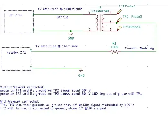

  • I have HP 8116A and Wavetek 271 generators with 50ohm outputs. I switched to using center-tapped xformer like in AoE. At 1st i wanted to see the signals w/o the amplifier. Please, see the diagram in the original question (can i add pictures to comments?). Does it look ready to be connected to the amplifier circuit? – vgeng Aug 02 '20 at 18:30
  • @vgeng Place two separate 10k resistors, each connected on one end to ground, with the other ends to TP1 and TP3 (unconnected to long tailed pair) and see if you still see the same signal amplitudes at those test points. That's about the loading the transistors will present. Separately, under no circumstances do you want your differential signal to exceed about 10 mV peak, or 20 mV peak to peak. As you increase towards 100 mV peak you are moving the BJTs towards saturation and that's a problem. Is your transformer "heavy iron" so it handles that low frequency well? – jonk Aug 02 '20 at 18:39
  • Finally! Just like in SPICE (sorry i had to peek at it) ,in the built circuit I see the bad signal with "long tail" and nice clean one with mirror and sink circuits. As you recommended i reduced diff. signal amplitude to 10mV (input to xformer 100mV). I got the gain of 36.3, so very close to predicted 36. Is the reason the diff gain must be <= 10mV, because we want Vc >= Ve + 0.2V? I have to review that. I cannot gather from the xformer spec if it is heavy iron, but i could see good signal at 1 KHZ w/o attenuation. Thanks for your help. – vgeng Aug 03 '20 at 00:48
